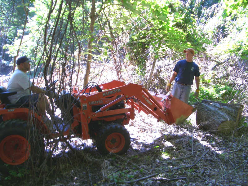

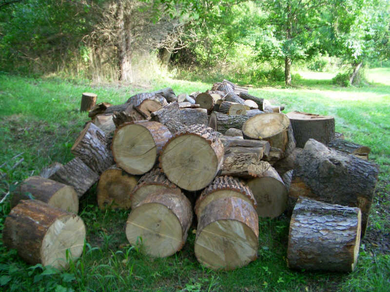

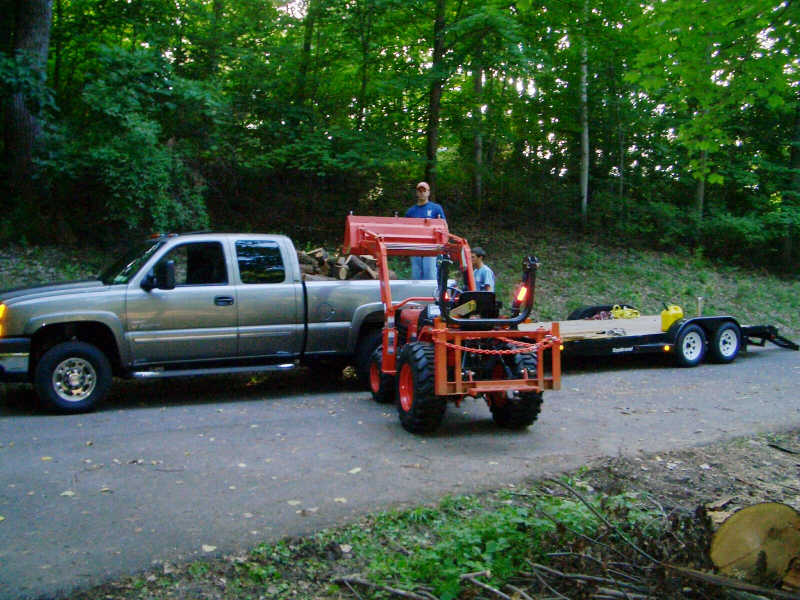

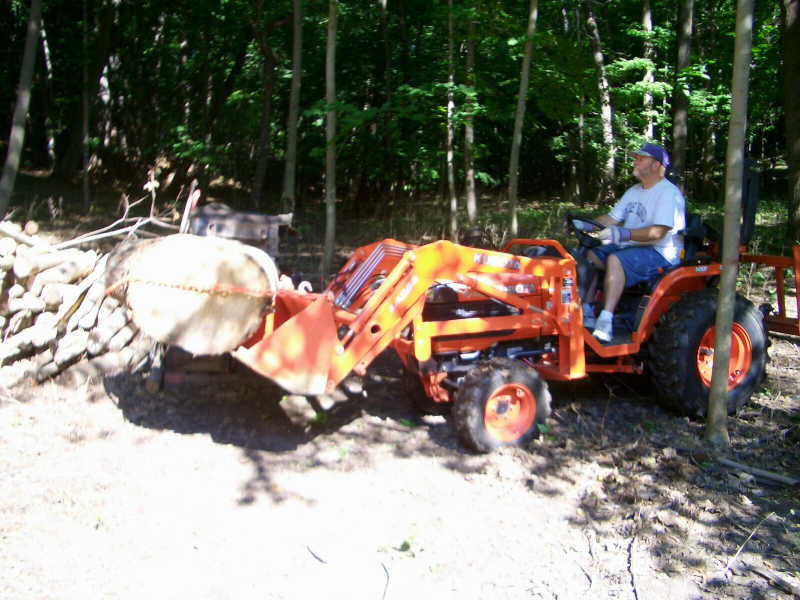

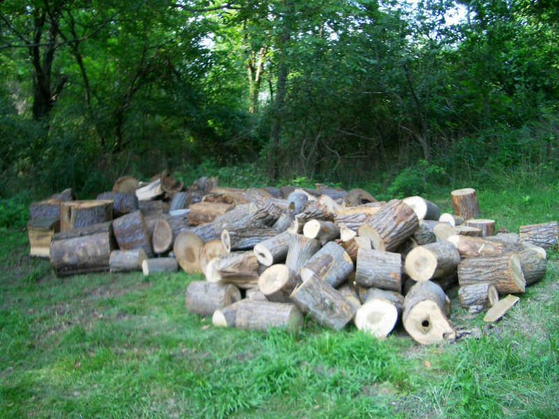

Ok, I got a little firewood splitting project that in the past I probably would have tackled with the maul. But some of the stuff is a bit knarly and runs up to 4' across so, in another sign old age may be catching up slightly, I've decided to rent a splitter.
I know cycle time may be more important than HP, but how big (HP) should I rent? Can you get fast 2x backstroke hyds? I know a combo vertical/horizontal stroke is more flexible and friendly on the back. So what else should I be looking for to get the best bang for my rental dollar and make the job go quick 'n easy?
Oh, and here's the catch... I'm also kinda interested in evaluating a splitter for potential future purchase, so I do not want to just rent some little weekend handyman special. I would rather rent a more substantial unit with the features I'd be happy to live and work with for many years. Any particular brands models stand out? If you were buying, tell me what features would you want so when I call around I know what to ask for!
Thanks much.
