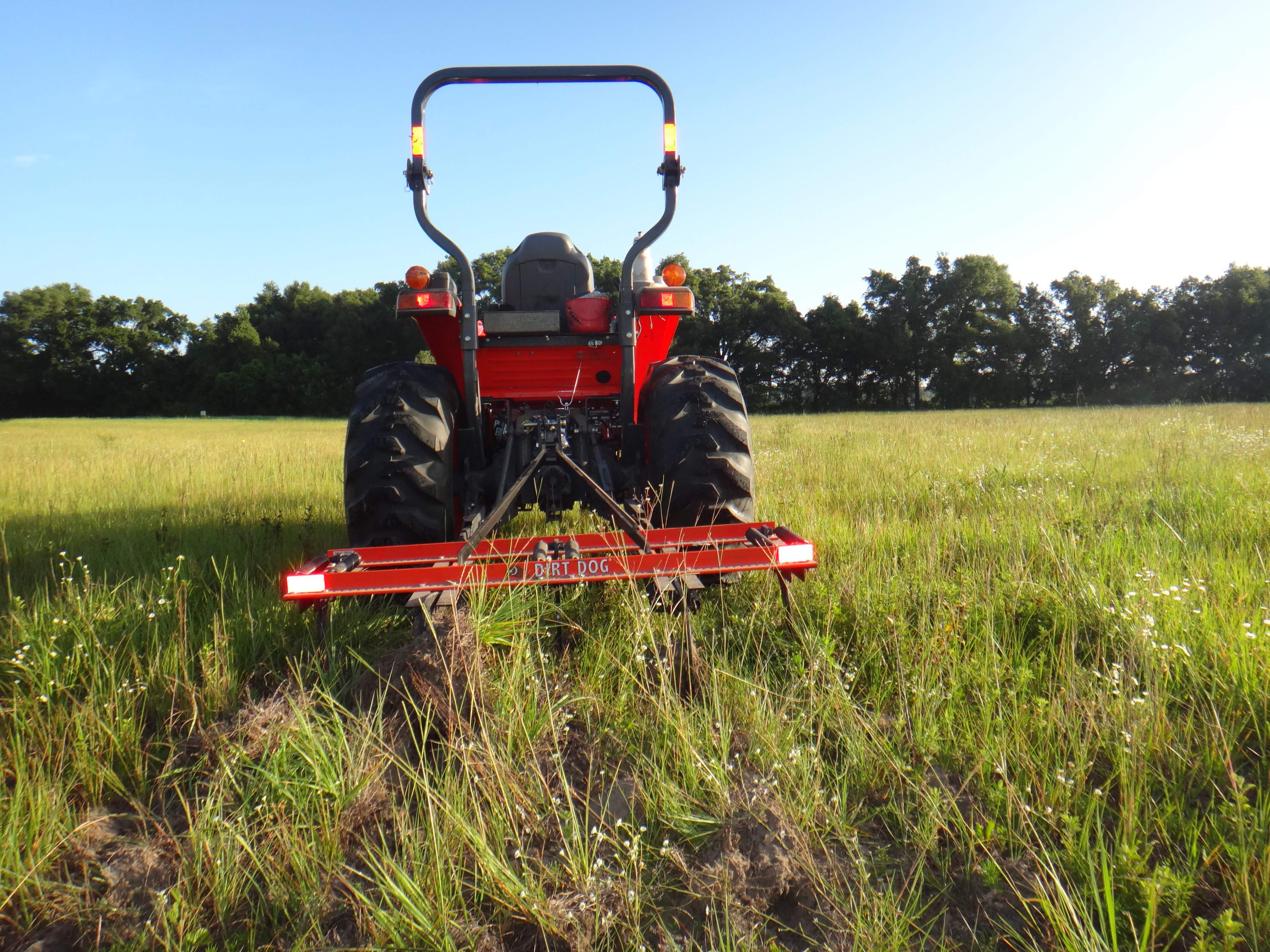

I pull a 66" five shank Dirt Dog brand Field Cultivator behind my 3,600 pound, 37-horsepower Kubota L3560. A good match. The Fred Cain F/C and Dirt Dog F/C seem to be constructed of identical components.
Your Deere 5103 is around 5,000 pounds if 4-WD and should be well matched to the Fred Cain seven shank.
Field Cultivators are engineered for secondary tillage. Chisel Plows are much heavier and are engineered for primary tillage.
If you contemplate using the Fred Cain in soft unbroken ground be sure the soil is moist at least a deep as you intend to penetrate. Penetrating 8" will not be a problem in moist, fairly soft soil. Dry ground will defeat you and likely break points.
A Field Cultivator is NOT a Chisel Plow nor a Moldboard Plow in its ability to handle tough soil and primary tillage.
MORE: https://www.tractorbynet.com/forums/attachments/339095-dirt-dog-all-purpose-plow.html?highlight=
COMPACT TRACTOR 'TRUE' CHISEL PLOWS:
Buckeye Tractor Online Catalog Page 18-01 Chisel Plows

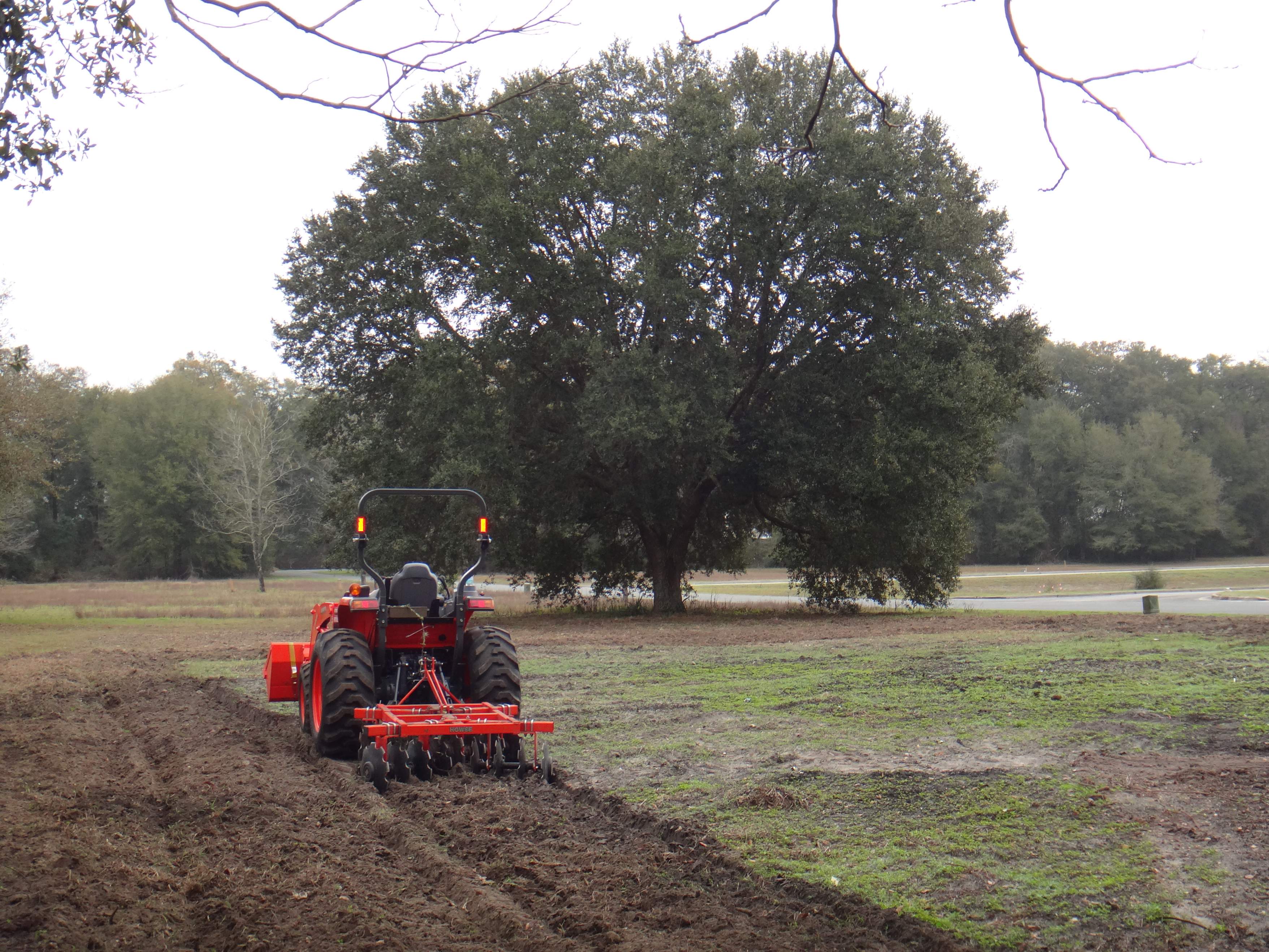

Ground described above will be too hard for a Field Cultivator. Nothing packs earth harder than animal hooves.
You should be able to find a used 12" two bottom or three bottom Moldboard Plow for $300 to $600.
A 12" plow is the traditional sodbuster's plow. A 12" plow cuts a furrow 12" wide, 5" to 7" deep, the penetration you are looking for. A two bottom 12" plow will turn soil in 24" swathes, a three bottom 12" plow in 36" swathes.
Where I live in rural Florida it is pretty easy to find contract plow operators. They use 12" plows, usually in eight bottom configuration.
14" plows are common too. A 14" plow cuts a furrow 14" wide, 6" to 8" deep. (Etc.)
After you plow the soil will be more productive for ten years, then it will be time to plow again.

Best to plow prior to first Fall freeze. Let inverted soil sit through Winter. Use a Disc Harrow to knock down plow furrows in the very early Spring.
I speculate you could sub a rear/angle blade for the Disc Harrow, to knock down furrows.
