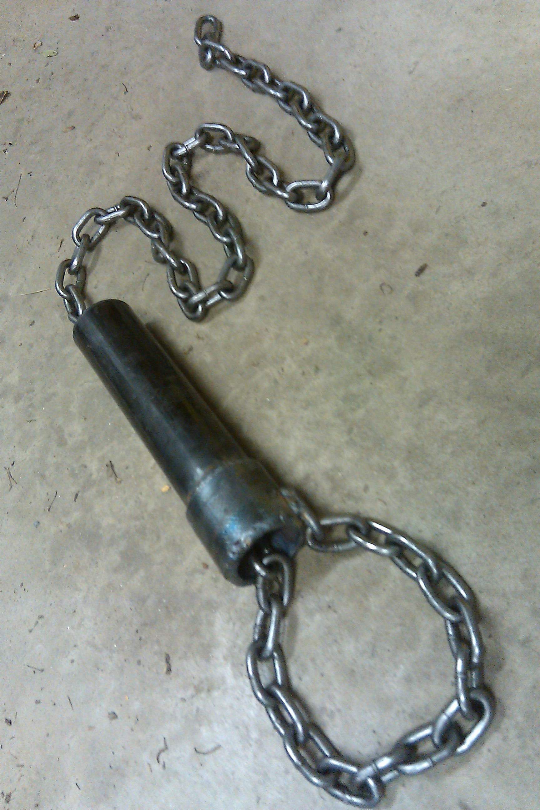

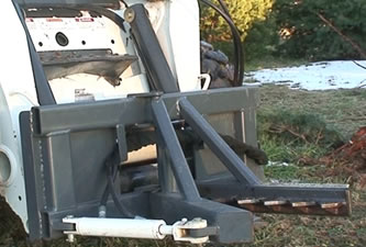

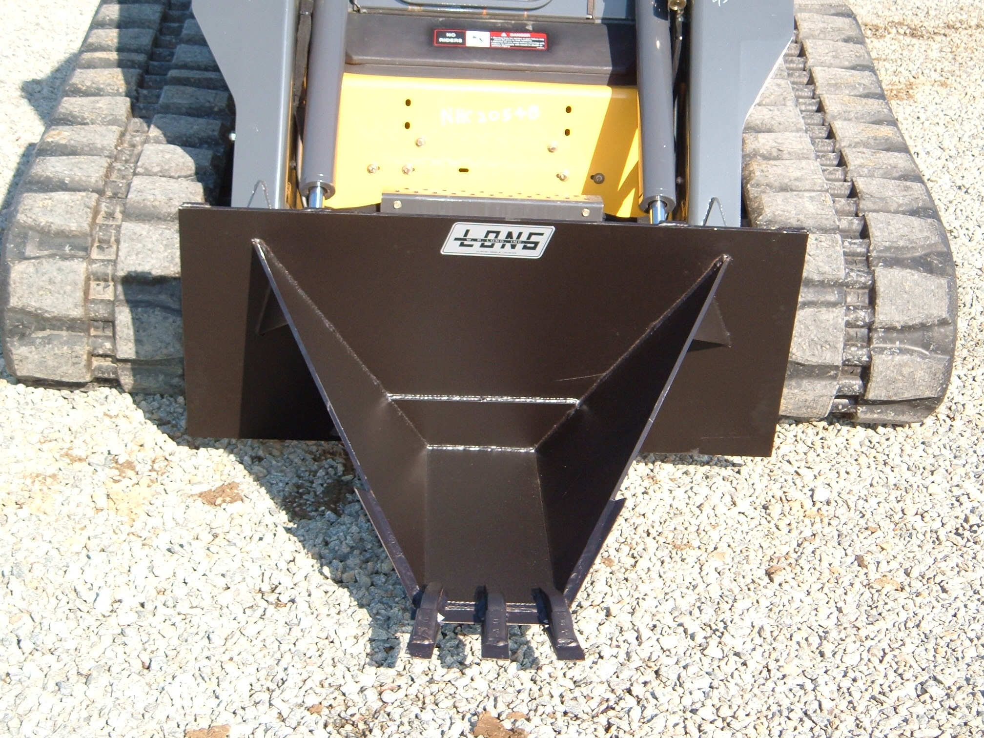

Perhaps something like these.

Use that chocker, that JJ showed in his last photo, to a good logchain, and pull them over. Hook to the drawbar.. that lowest thing on the rear of the tractor, NOT the 3pt arms we are talking about the drawbar that is fastened on the bottom of the axle housing of the tractor. about 1 foot off the ground. If you fasten up high is when all the bad things happen, also try to pull downhill with the nose of the tractor pointing downhill, NOT uphill. Go slow and pull gently, and most 2 to 5 inch trees will rip out. expecially a few days after a rain so the ground is still moist. There are exceptions, some trees are rooted in bedrock, cedars are expecially hard to get out sometimes. If you dont have a chocker, or dont want to make one, you can just wrap the logchain around the trunk a few times.. Now dont go pulling on trees bigger than 4 or 5 inches, depending what size tractor you have, and if you see the front end raise up or get light at all stop. something is wrong, you have either hooked too high or the nose of the tractor is uphill. Putting a load of dirt or gravel in the bucket can also help some. Others on here may say even this is dangerous, I dont think so if done with care, I have ripped out trees (saplings really) with thsi method for years without the front end ever coming up on me, all I ever had happen is the wheels spin when you hook on to something too big. Be carefull
