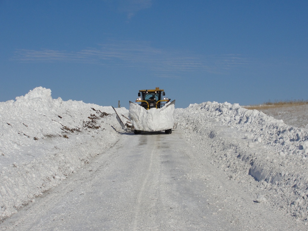

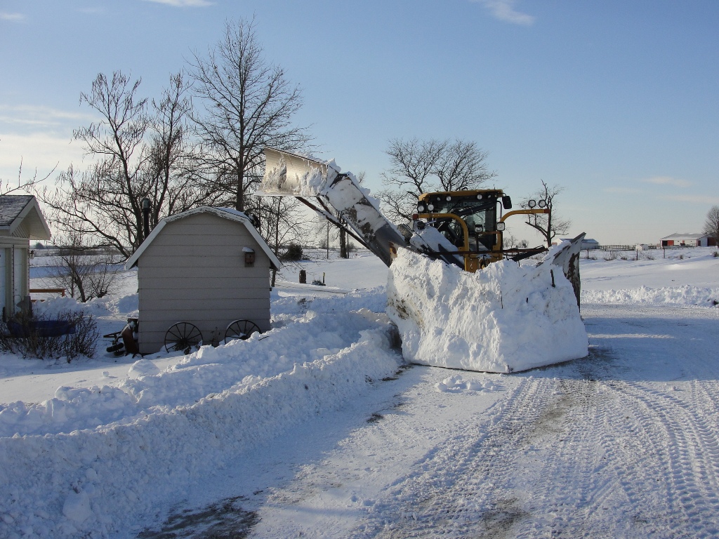

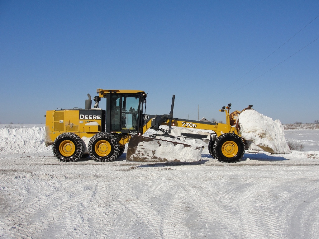

This is a much debated topic. There will be all kinds of "witches brew" recommended with assured declarations of success. Good luck.
If snow conditions are right,,,, or wrong as it would be,,,, you will get snow buildup on your blade or V plow. I've even stopped and beat it all off. Only to have it built back up within a few minutes of running. I'm talking big equipment. Your results might vary...... :)
