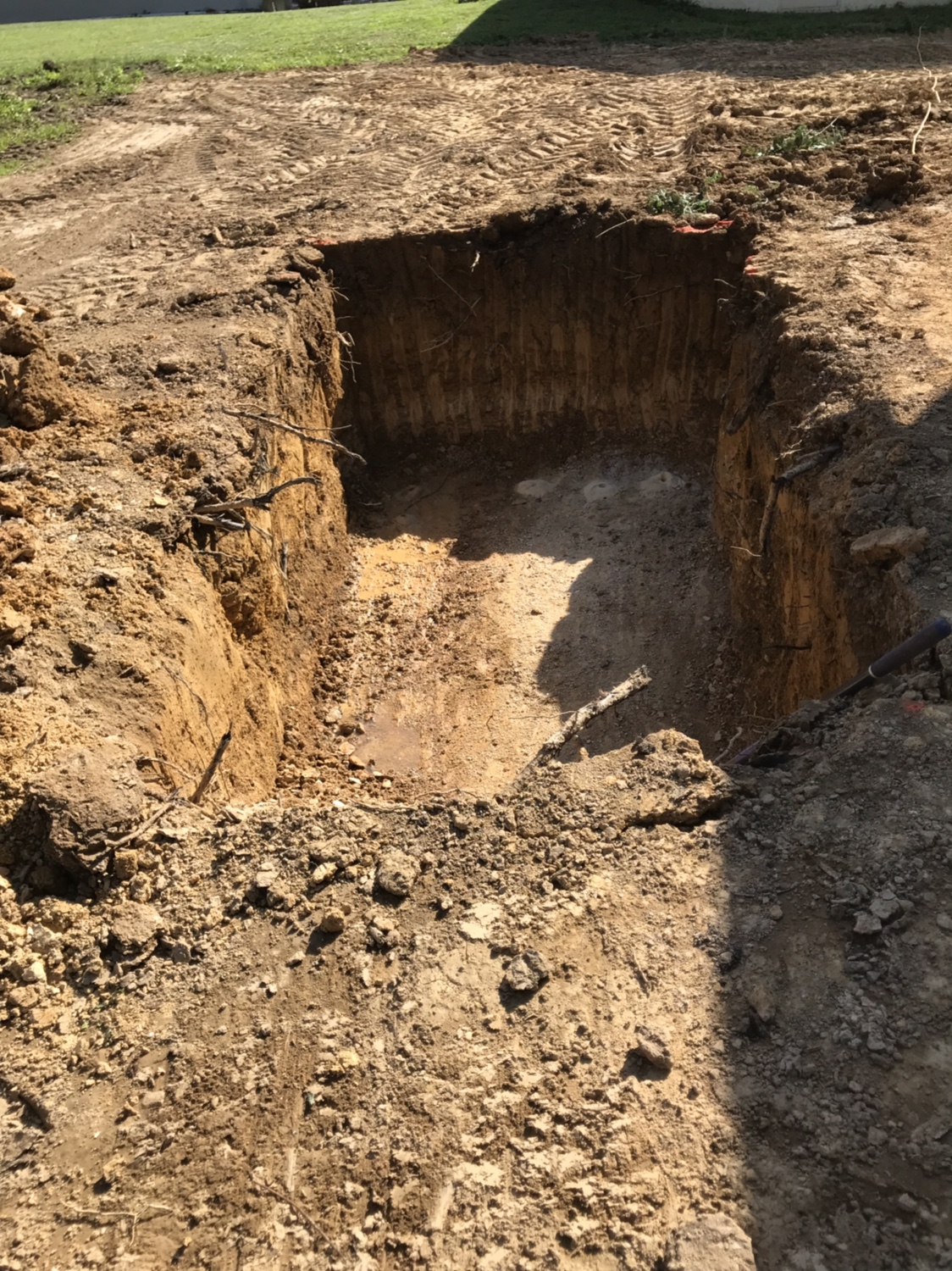

I dug a 6x12 5’ deep hole on my 310 backhoe in 18 minutes and that was being careful to keep nice sidewalls. It would probably take me twice or maybe a little less as long on the M59 IMG_6942.JPG

I dug a 6x12 5’ deep hole on my 310 backhoe in 18 minutes and that was being careful to keep nice sidewalls. It would probably take me twice or maybe a little less as long on the M59 View attachment 664983
as much as a full size machine would be awesome, I would have trouble trailering it around from house to house. Also they don't have 3 point hitches for a Post hole digger which is a deal killer. But that's a nice hole ! :)
