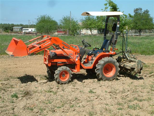

You could level the lawn area with a small tractor with a rototiller. My first tractor was a new 2005 Kubota B7510HST (21 hp engine, 17 hp pto, 4WD, power steering, hydrostatic tranny) with the LA302 FEL (4-ft wide bucket, 800 lb lift capacity). Cost: $12,600 plus tax. You can find a similar vintage used tractor for $8-9K.
The rototiller was a used $300 Yanmar RS1200 (48" wide).
To maintain your lawn area, I'd get a nice ZTR mower.
