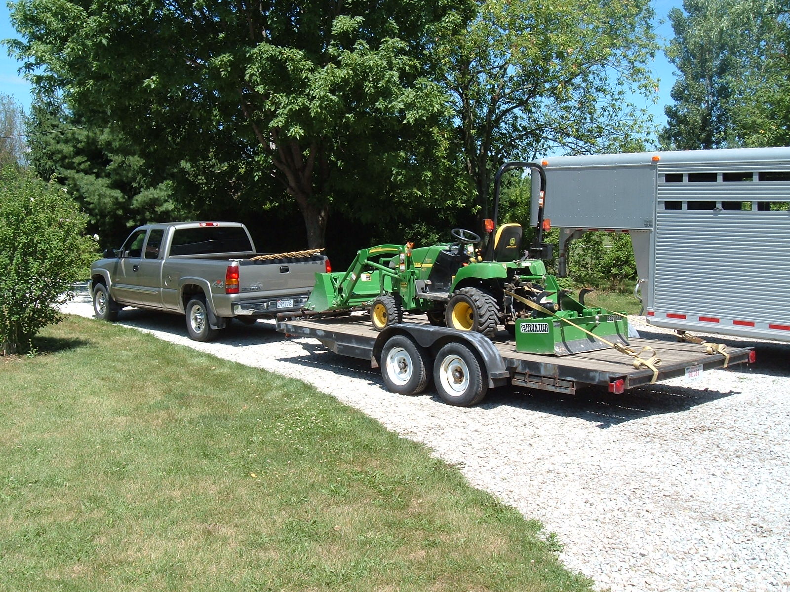

With the rotary cutter on the tractor, it just about fills my 18' trailer and still gives me a little room to balance the tongue weight.
It also works well for hay bales without having to stack them too high.

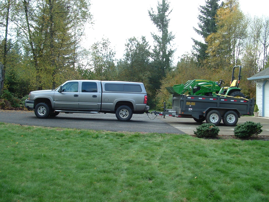

I have a heavy duty 12' dump trailer, and I totally agree with everyone else, you really should look at a longer trailer. I bought mine to help out a family member, otherwise I definitely would have went with a longer trailer. I don't need to haul the tractor much, hence I prefer the dump trailer (which has heavy duty ramps if I do need to load the tractor), but as you can see in the picture, 12' just barely makes it, and 14' wouldn't really give you much more room. Granted your tractor is smaller, but still...

Jeffster, Question for you. Is that a 3000 series in your pic? If it is I have the same setup and can fit the loader in the dump box. Are you sure your trailer isn't 10 ft? I went and measured mine and it's 12 ft inside the box. Just curious.
