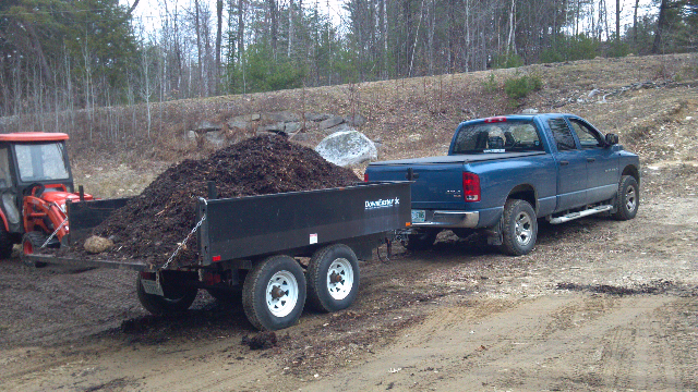

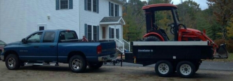

My 10k GVWR 6x10 dump trailer weighs 1870 lbs empty. With the 6-7k loads your looking for, you'd be around 7800-9000. A decent 1/2 ton truck will pull that safely even if most think you need a 1-ton dually for 10k...
I know as I've done that load a handful of times plus 3/4 of that load many times with my "old" 03 RAM 1500 4x4 HEMI quad cab with 3.73's.
I've put my 4k lb tractor in that trailer as well and a 7400lb mini ex on a 16ft utility trailer. All in all, the "heaviest" load I've pulled with this truck by feel is the 5k 27ft travel trailer. Feels much heavier than it is at highway speeds.
With the dump trailer, there's much less tongue weight but a good WD hitch is nice.
Find a good 1/2 ton with the most powerful engine available and lowest gearing (highest numerically) and you'll be fine.
