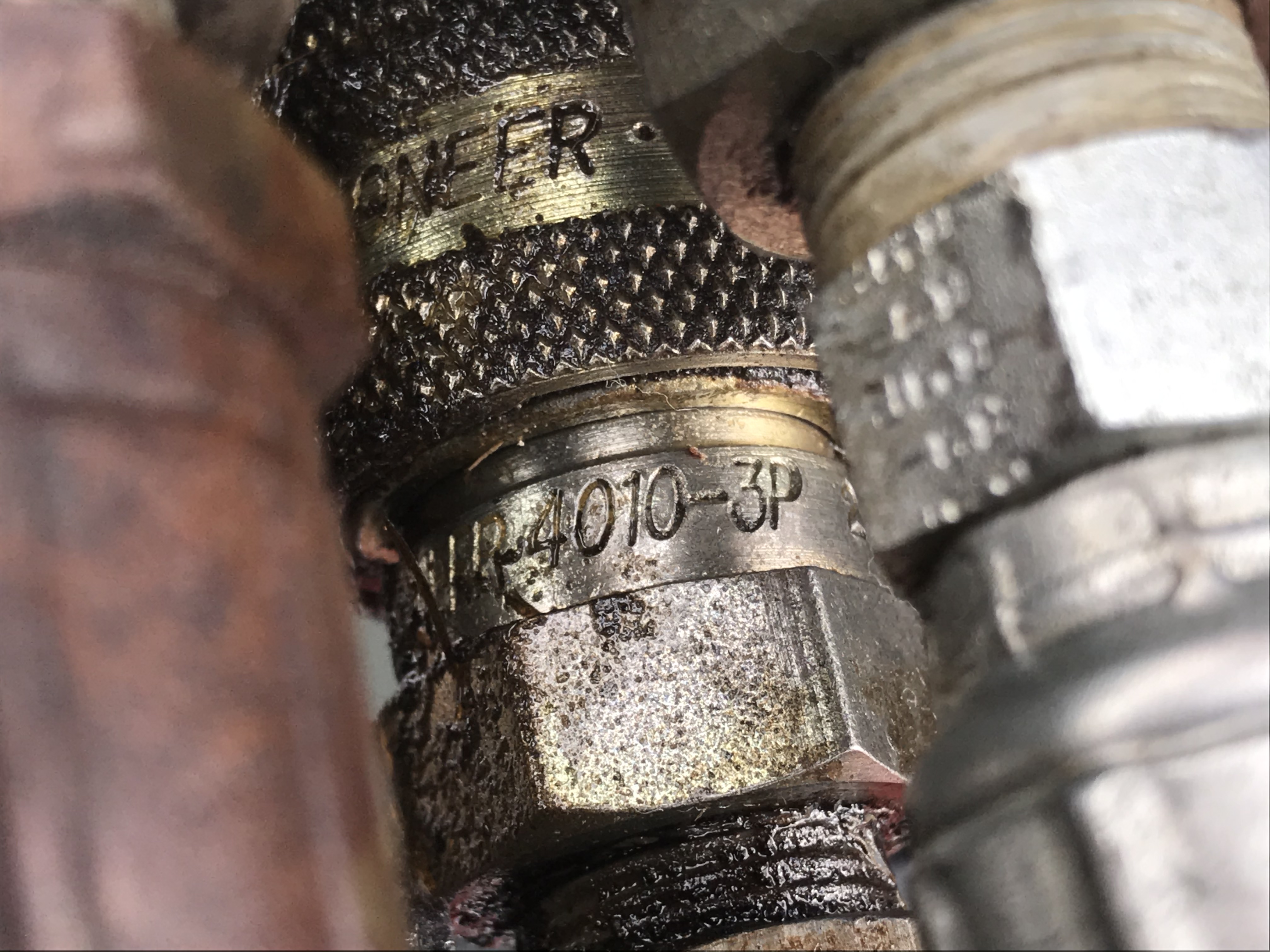

So I need to replace the joystick control for the loader on my tractor (2006 Branson 4720 with BL20A). Are there any TBN'ers out there who can tell me what type ports this loader uses? BSPP, JIC, etc? I've attached pictures of the return port and one of the cylinder spool line ports - hope they are useful, and will attach more if needed. Thanks in advance, my friends.

The 4010-3P in first googles to A Parker fitting. The second fitting where it goes in the black is similiar to ORFS fittings but that is a guess.
   / What type are the ports on a 2006 BL20A loader joystick control? #3
The 4010-3P is a 3/8 npt threaded quick connect,
and the others appear to be ORFS fittings going to JIC hoses
