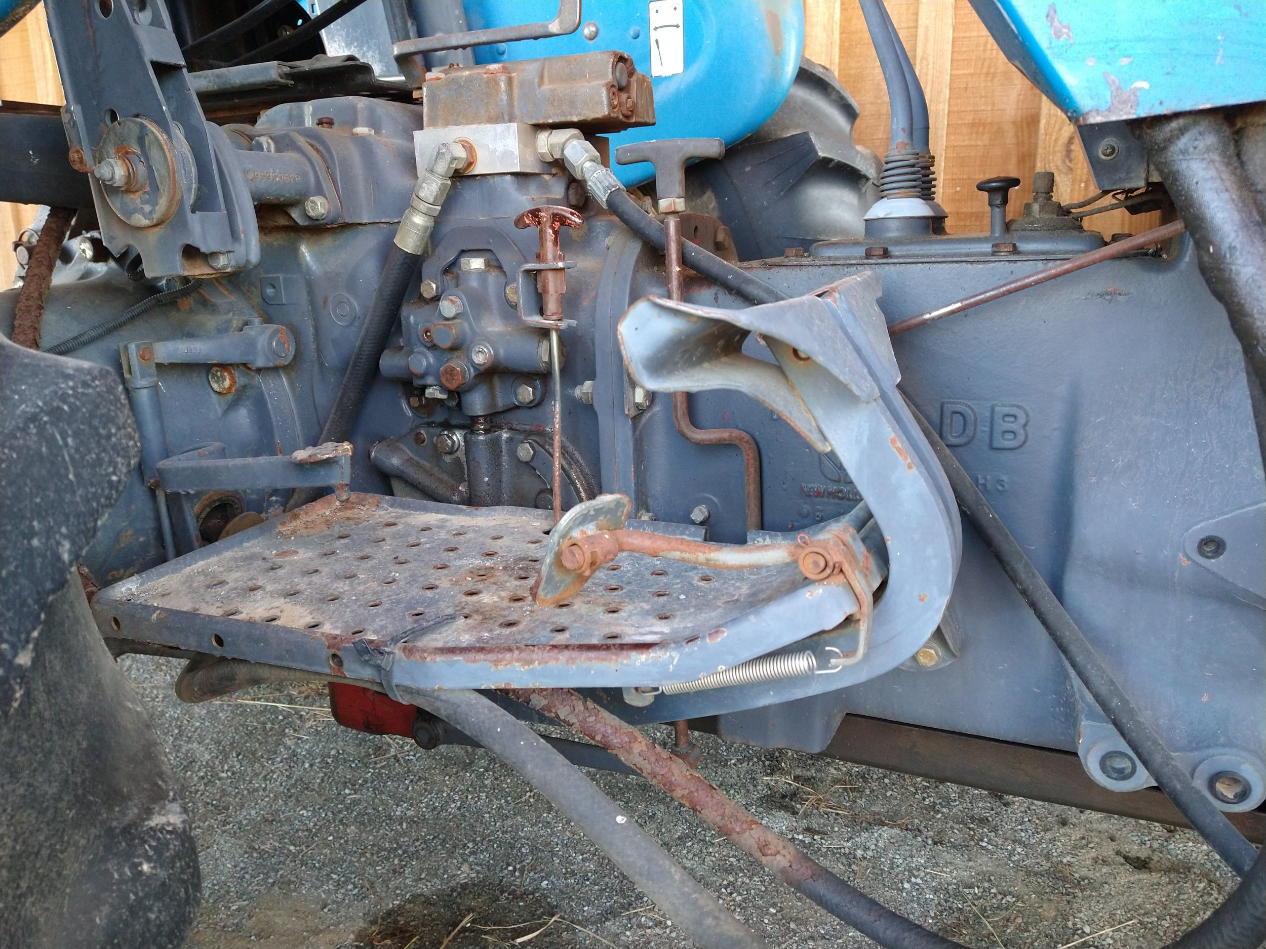

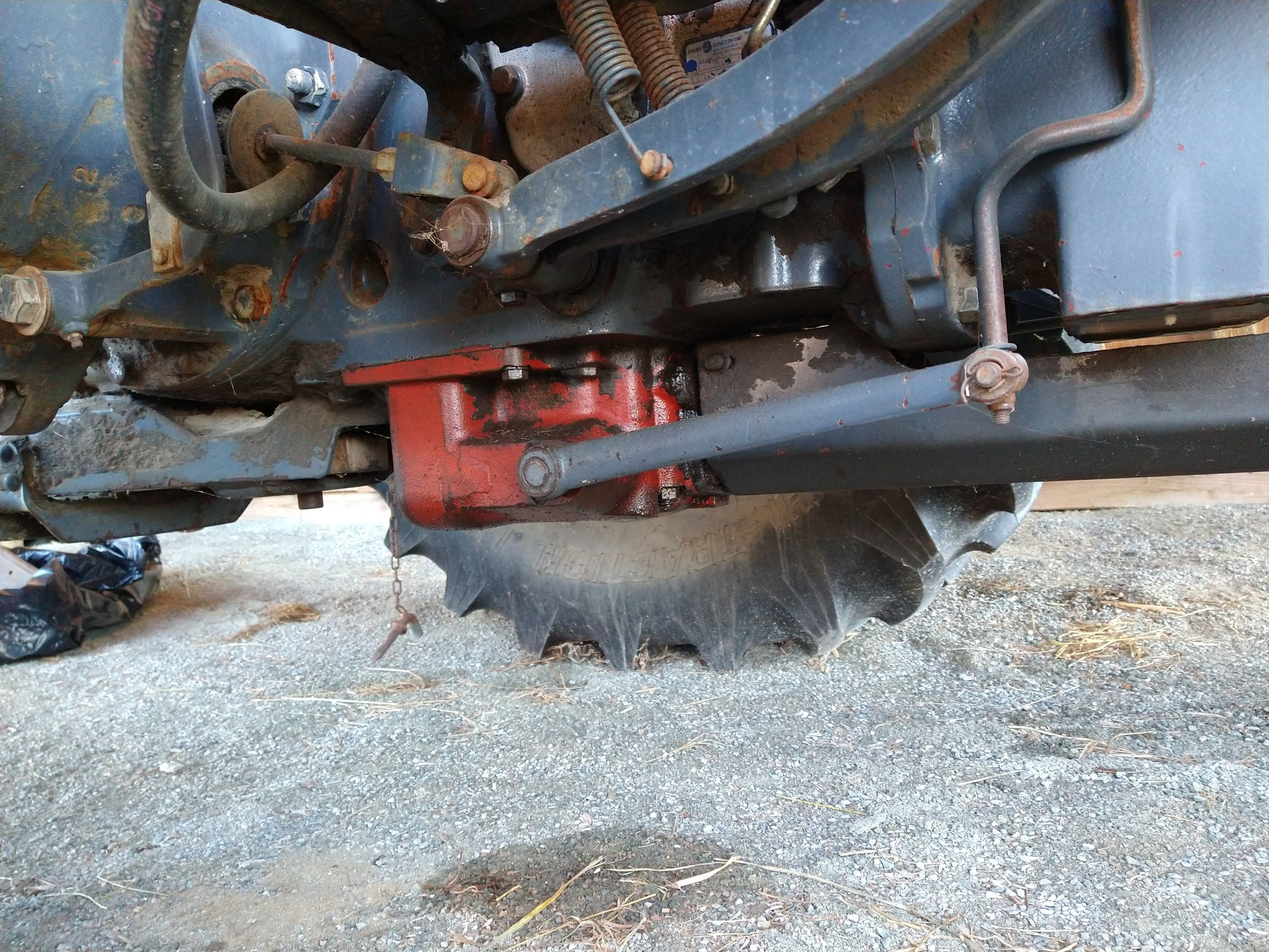

Hey RickB: Thank you for providing the information above for hydraulic refills. Any insight on where the drain plugs are for the 3 separate compartments? Appreciate any help, thanks!
