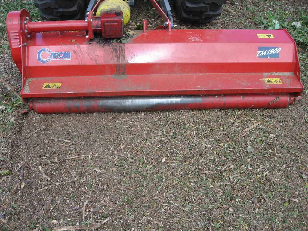

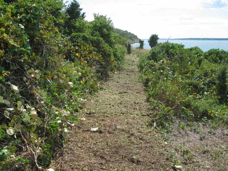

While it is hard to disagree with advice to start off with a heavy duty rotary cutter, I would put in a word for flail mowers. There are different types of flails and some are just as heavy duty as the big rotaries. They are pricier for the same width but the advantage is that you have a more compact mower that can be used for near finish mower work as well as handle any blackberry bush like object you might come across. The only area I'd definitely favor the rotary for is if there are lots of uncharted rocks etc. Those won't damage the flail but they will wear out the knives/hammers more quickly and those parts are both more expensive and more time consuming to replace than a blade on a rotary cutter.

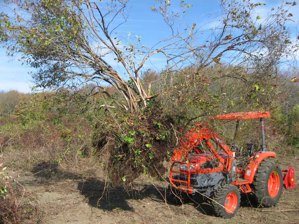

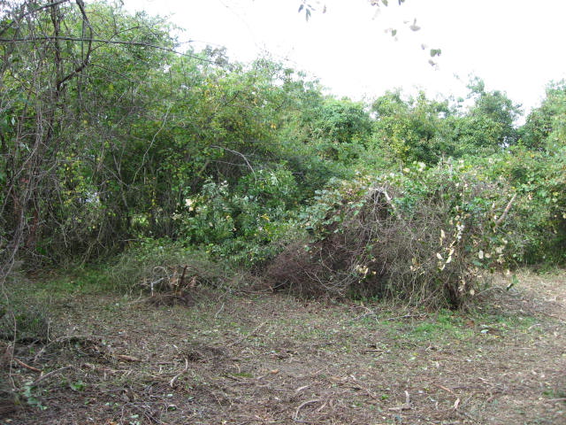

I am currently clearing a couple of pastures that have been abandoned for thirty years. My tools are a grapple, medium duty flail mower and 40hp tractor. I clear some areas just with the flail as that is definitely the fastest way to go but when an area has lots of thick bushes with multiple stems more than an inch thick, I have been simply uprooting those with the grapple and taking them to a burn pile. If I had a big rotary cutter and more HP I suppose it would go pretty quickly if I simply backed into those bushes but then I'd have tons of sticks and debris all over the pasture for years to come. The nice point with the flail is that it truly mulches rather than just breaks bushes so the resulting surface is really clean in comparison.
Here are some photos of the type of brush I am cutting with flail or grappling instead of flail cutting. I also put in a photo from bush cutting done with a bush hog for comparison. I'm finding this to be a pretty efficient means of clearing the land.

   / What type of mower do I look for?
That's a nice tractor you have there. I don't have a loader on mine yet. I just bought it in August when my old MM died while I was plowing for my winter wheat. I went all out on this one thanks to the new holland financing.
I planned to get a loader with a grapple also in the spring when I can hopefully save up cash for it. Hopefully!
I really do like the looks of what your flail mower does. That is a really great job.
They are more expensive but if it saves me time, fuel and expenses on doing this job, It will be worth it. Both of the old pastures on that old farm were about 40 acres if I remember right. Right now you can't even tell they used to be pastures. I know I'm going to be doing a lot of chain saw and crosscut saw work too but every bit I can get done with the tractor is a big help.
