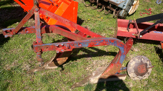

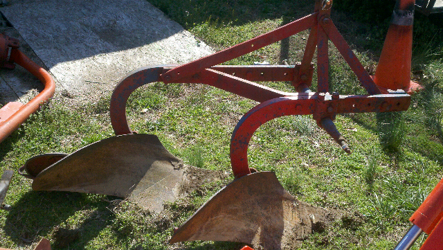

What type of plow is this, I paid only 25 dollars for it. I think I got a good deal. This lady old man died and she basic just giving stuff away

It's a two-bottom 3 ph moldboard plow without coulters.
It turns the ground over into the furrow. Much better plowing job than the middlebusters that just stir up the ground (but they have their place too).

It is either a Early Ferguson or Dearborn with 2 piece setup. Use it until it wears out and then scrap it. Parts are not available for that plow. Ken Sweet

It is a Fergeson Sherman. I have the same one and The person I got it from installed Oliver moldboards and shares on it.

Can you get me a source phone # or website or part # or anything for the moldboard and share. I have dozens of guys looking for these things? Ken Sweet
   / what type of plow #8
Ken. just went out to get #s and looking at it they installed the whole section from the Oliver one bolt hole did not line up. I have to clean up the landside to find a #. both moldboards are nc219-14, I cant see all the share unless I take it off but what I did see is 0014. It is raining now. If I learn more I will let you know.
I do need moldboards if you have any.
