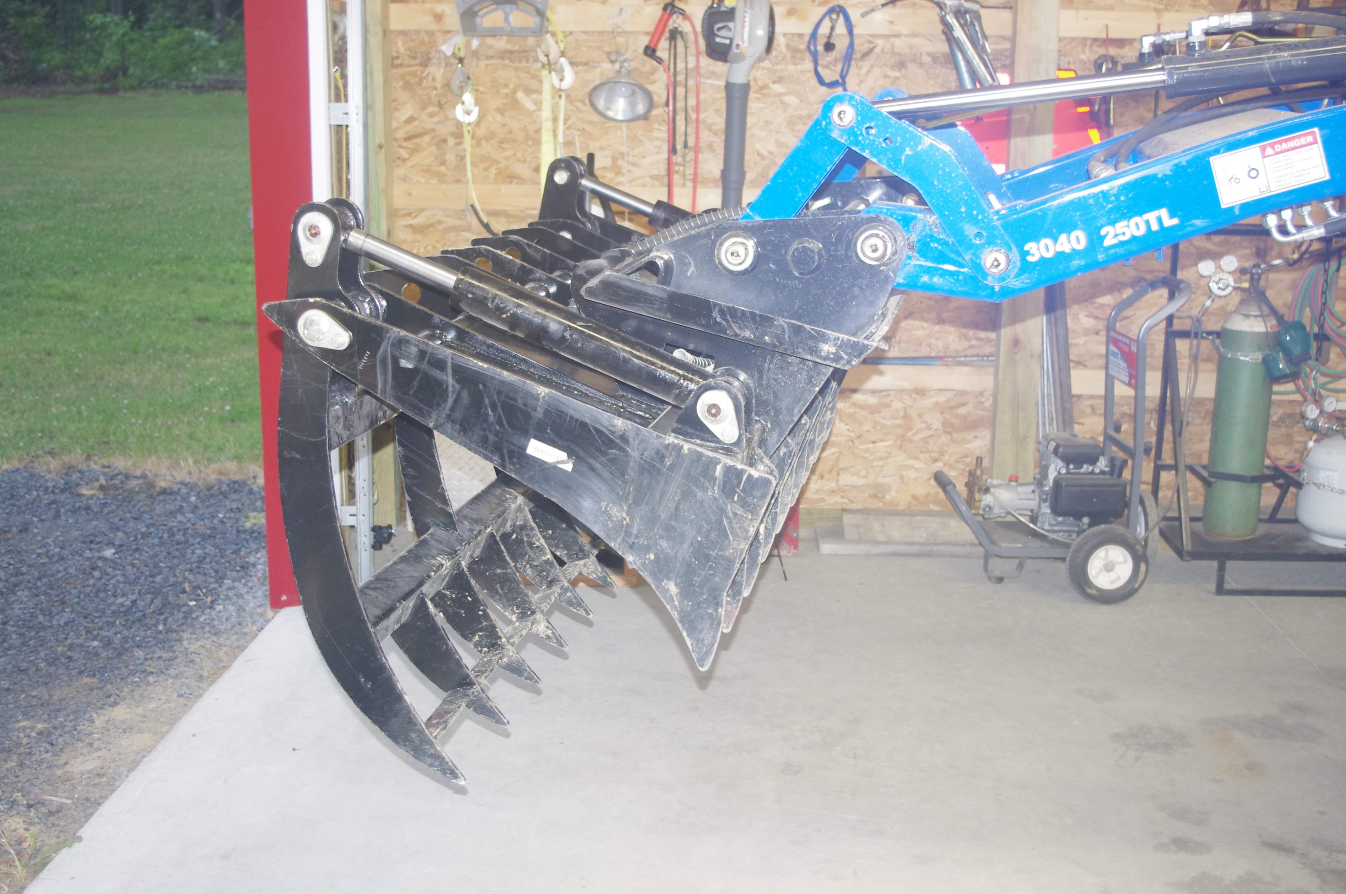

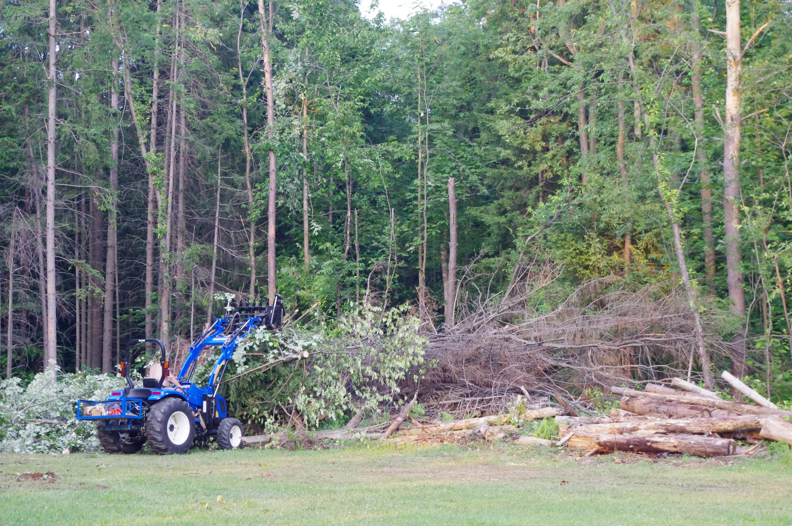

dex3361,
I bought a different brand from Skid Steer Attachments Pallet Forks Hay Spears Bobcat Cat John Deere Mount Plate and picked the 60" instead of the 72". Weight was a concern as was having it to wide to slip in between trees. The Anbo unit is a high quality product and you won't be disappointed. My unit weighs about 550 lbs and works good for what I need it to do. I cleared a piece of my property this summer and had quite a pile of logs to clean up. Since then, I've used it for moving large rocks, stumps, and clean up of road I have that goes to the back of the property. It's turned into a real handy tool.
Nice looking grapple they will spoil you when it comes to lifting stuff.
