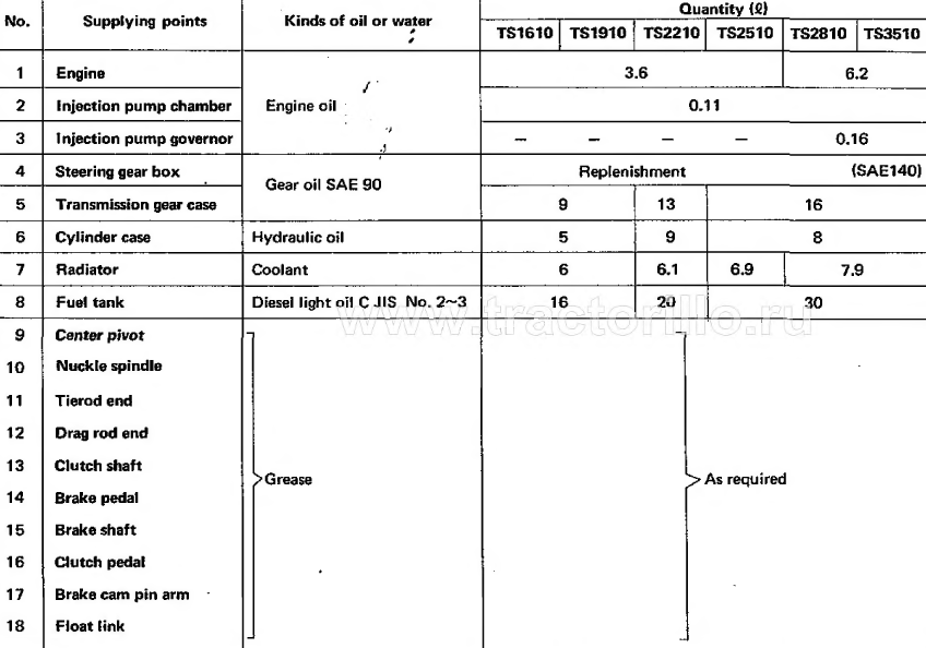

Looking at the dipstick the oil looks like a heavy transmission type, not the thin hydraulic fluid type most newer tractors use. Does anyone know the
correct fluid for the Trans/hyd.

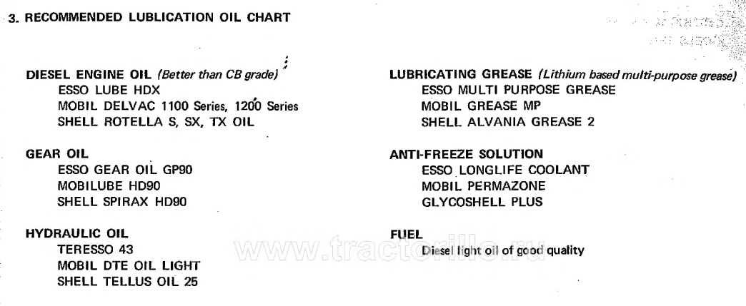

I found the manual today for the TS series, as I just got something like a TS3510.
Here is a screenshot from the fluids page:
   / What type of trans/hyd fluid for Iseki TS1910
Thanks, my tractor looks like the transmission/rearend/hydraulic are all the same fluid area. It's always though when you don't have a manual.

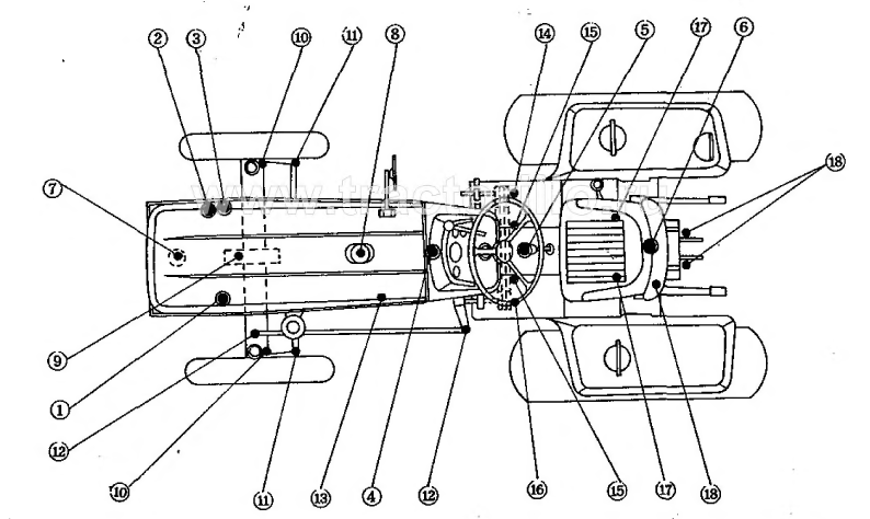

Hydraulic is separate from transmission. The transmission gets filled from the plug next to the shifting levers, the hydraulic from a screw off cap next to the lift arms.
   / What type of trans/hyd fluid for Iseki TS1910 #7
This should help you:
Thanks Andrew,
The diagram and website are great, lots of information. I can see the hydraulic has a seperate filler cap transmission so now I know to use modern hydraulic fluid, before I thought both transmission and hydraulics were the same.
