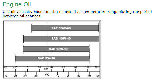

It depends on your ambient operating temperatures. For the Kawasaki FS730V used in the X500 the OEM Kawasaki owner's manual has this oil chart:

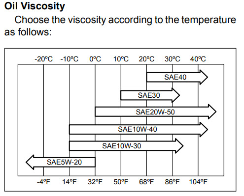

The John Deere owner's manual for the X500 has the following oil chart:
