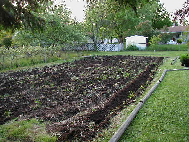

Not sure about hard clay, but here is what mine does on our rocky soil /forums/images/graemlins/grin.gif
Here is an old post of mine with more information as well.
BX1800 vs garden
