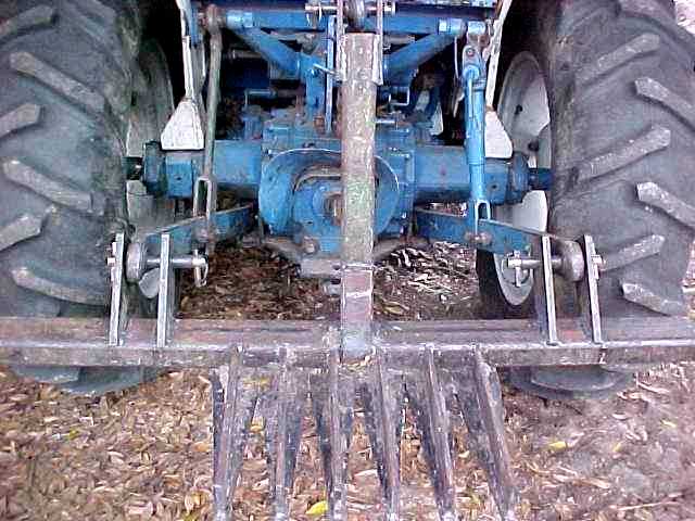

I have cut a lot of brush and small saplings with my rotary cutter, and as you guessed, it does sometimes leave sharp "stakes" sticking up. I try to avoid these areas with my ATV so as to not ruin a tire.
You might try something like the attached picture. I don't have one and did not make this one. There have been several similar posted in the past and I don't remember who to posted this one. It just yanks the saplings out of the ground. Some fit on the 3ph, some made to mount on the front. But for "miles of trails" it may be prohibitively slow. As someone else mentioned, it may be a good investment to have a dozer make a pass on it first.
