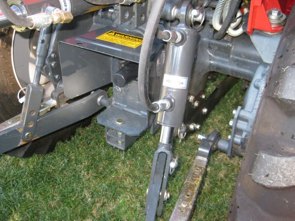

How I understand you, you want to install a tilt cylinder of a top and tilt setup. This is done all the time and as long as the cylinder is the right size, you should have nothing but good results.

A hydraulic tilt cylinder would work great.
I've been running a hydraulic top link and a hydraulic tilt cylinder for years on my tractor.
I highly recommend it!!
