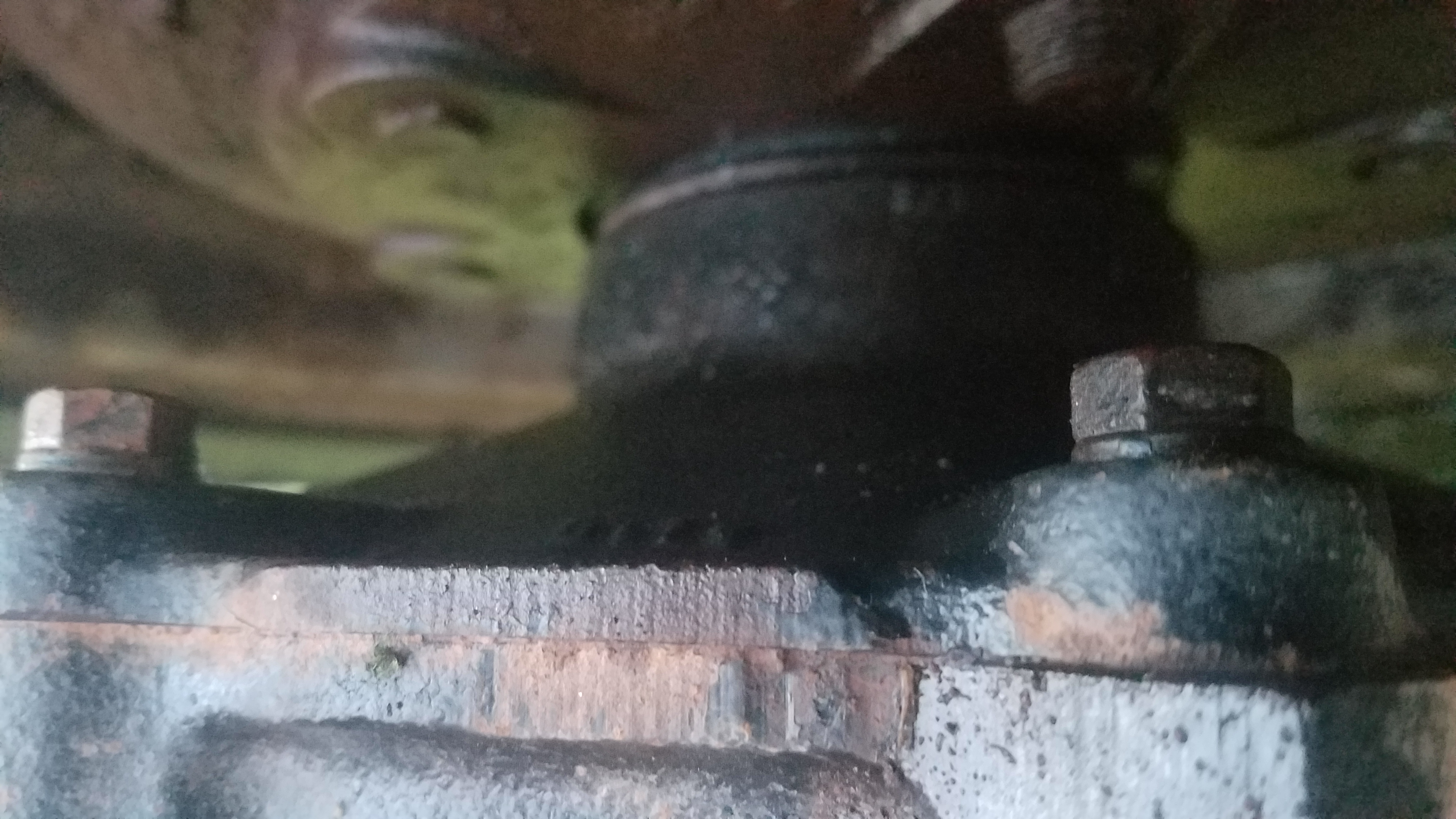

Was nearly done mowing today on a slight hill going across the hill in 4wd and felt a snap. Instant gear oil all over the place from the left front. Seems axle is broke, or the whole housing. I nursed it back to the house with it trying to lock up and the tire trying to pull out of the housing.
Its now a big red yard ornament once again. Iam obviously calling the dealer as soon as they open (hours are random, since they dont even have sales or office people apparently now)

Out of curiosity, could you post some photos of the front axle failure?

20200617_204417.jpg Hey sorry it took so long to write back. I cant seem to login this site from my phone.

The only pic I have is not very good. Looks like the hub is trying to come out just slightly from the spindle(?) Can't see where the fluid was coming from, unless it was just around that seal or whatever. The rate that it was pouring out, I was certain there was a fist-sized hole somewhere lol.
