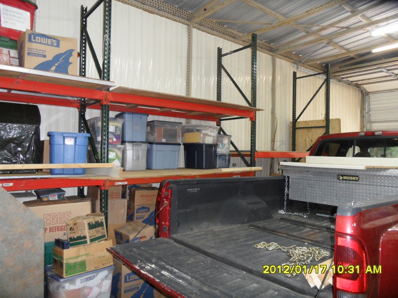

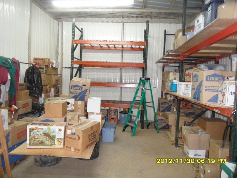

Many of the TBN'ers are what I consider "vertically challenged" for storage.
I rant and rave about the wonderful utility of pallet racks.
With sufficient pallet racking and smart storage practices one can quadruple the storage and work area. Get everything off the floor so you can use a leaf blower to clean it!
