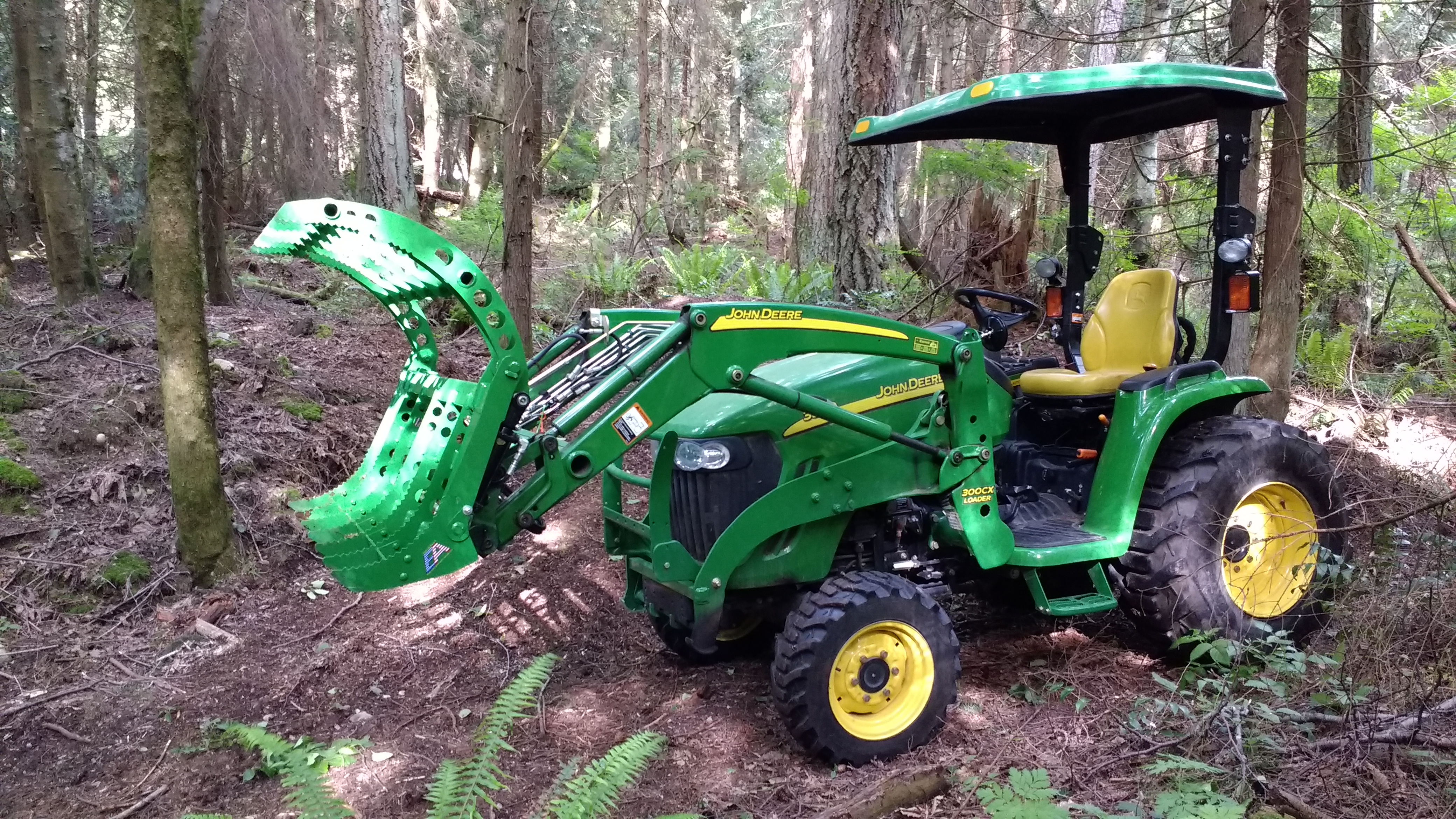

My 3320 has been bulletproof for 9 years now, zero issues other than a warranty repair of the adjustable steering wheel in its 1st year.
