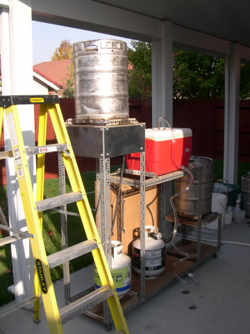

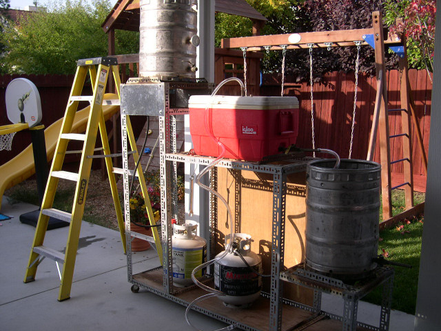

This is my setup. On the bottom is the boiler. The ice chest actaully holds the grain mixture soaking in hot water. The top keg is for heating water. As I took this picture, the boiler keg had the Aussie Ale starting to warm up, while the ice chest had the barley mash in it.

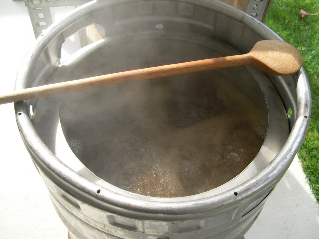

Here is 12 gallons of beer cooking. It will boil down to about 10 gallons when finished.

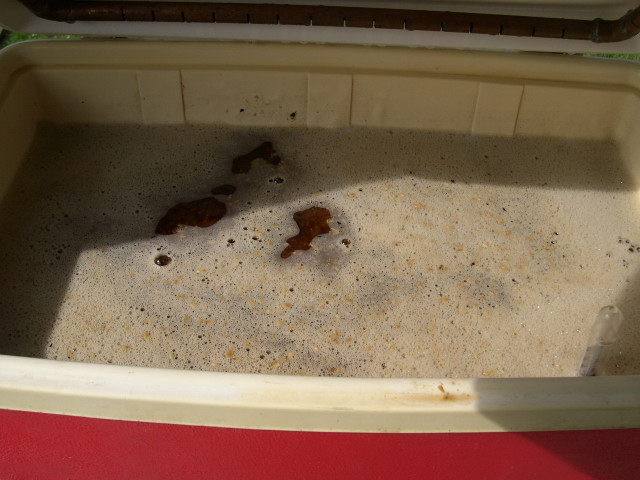

It is kind of hard to see, but that is 28lbs of malted barley "mashing" in the cooler. The lid of the cooler has a sprinkler arrangement on it. The bottom has a similar setup, for draining off the sweet wort(raw uncooked beer). If you taste that mix, it's like tasting sugar(well, it is sugar...).

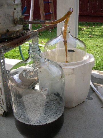

After cooking for an hour, the raw beer is chilled to about 75 degrees, cool enough to pitch yeast in to . These carboys then get an airlock, and go in the house.

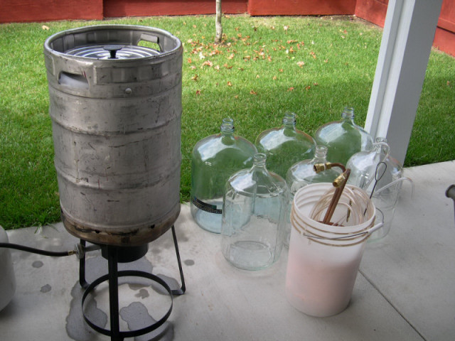

This is the second setup, using a modified beer keg as a cooker. The keg is stainless steel, and makes a nice cook set up once the top is cut out. This one will be getting a valve added to the bottom to make transfering the beer to the carboy easier.
