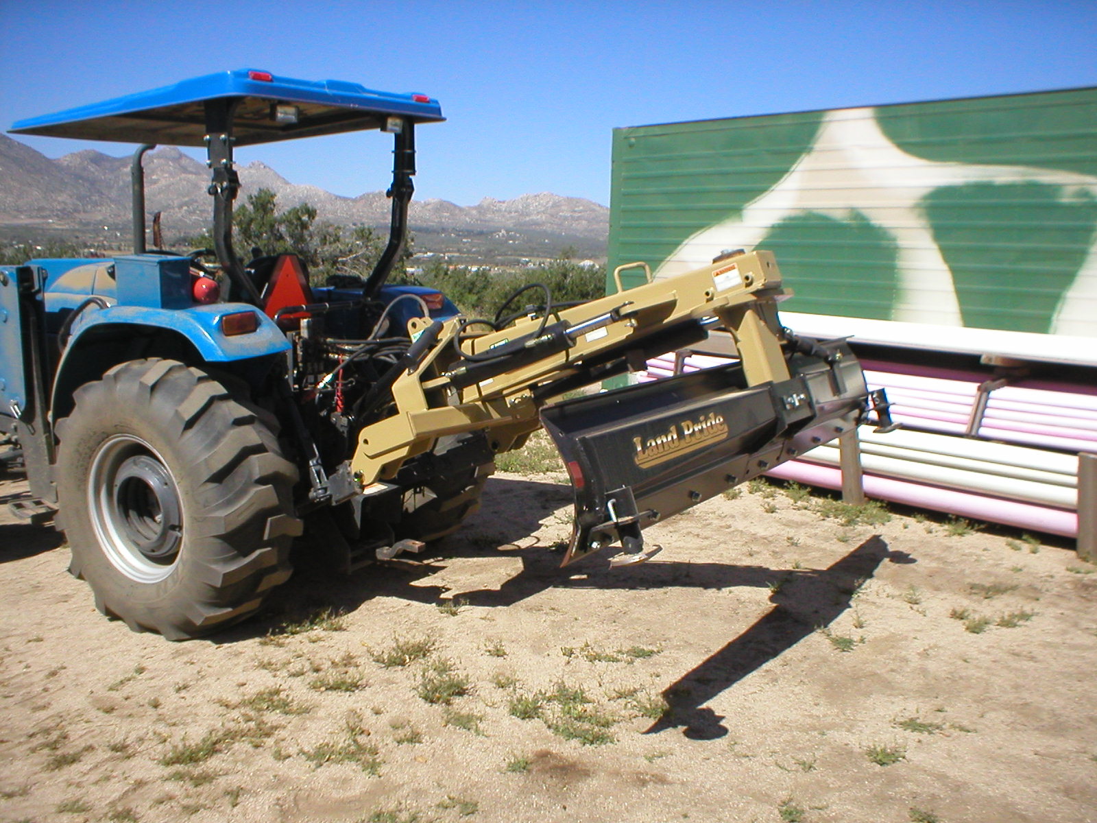

Brian, any pics available for your welded cylinders for the rbt?
And do you have the needed measurements for the rbt3584 as if I order one I won't have it for a while.

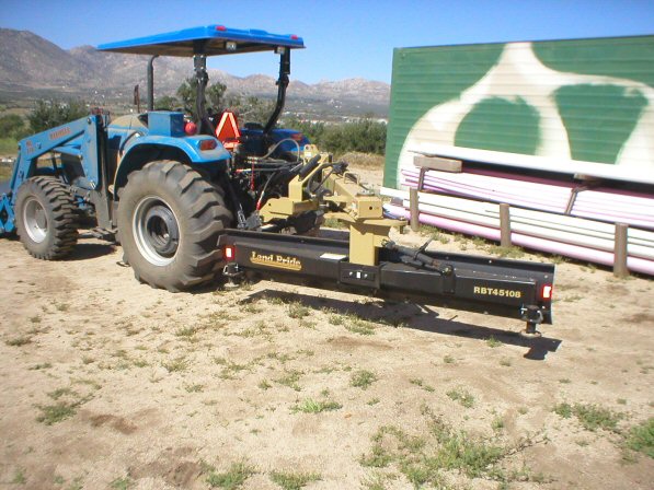

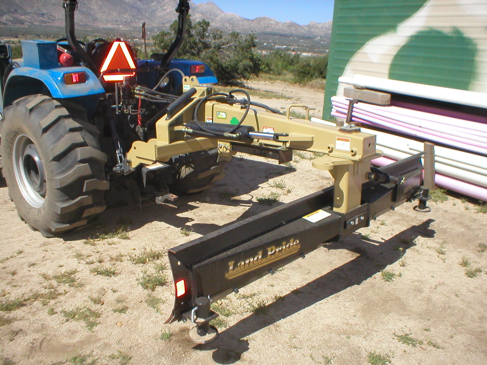

Have the measurements, actually have the cylinders sitting here, I will get some pictures up tomorrow. These are 3.5" dia cylinders, 1.75dia rods and a 14" stroke with clevis ends that have 1" dia pins. These pin right on and are ready to go. ;)
Here are some 4" dia units on my blade. Yours will be the same style, just a bit smaller is all. :cool:
