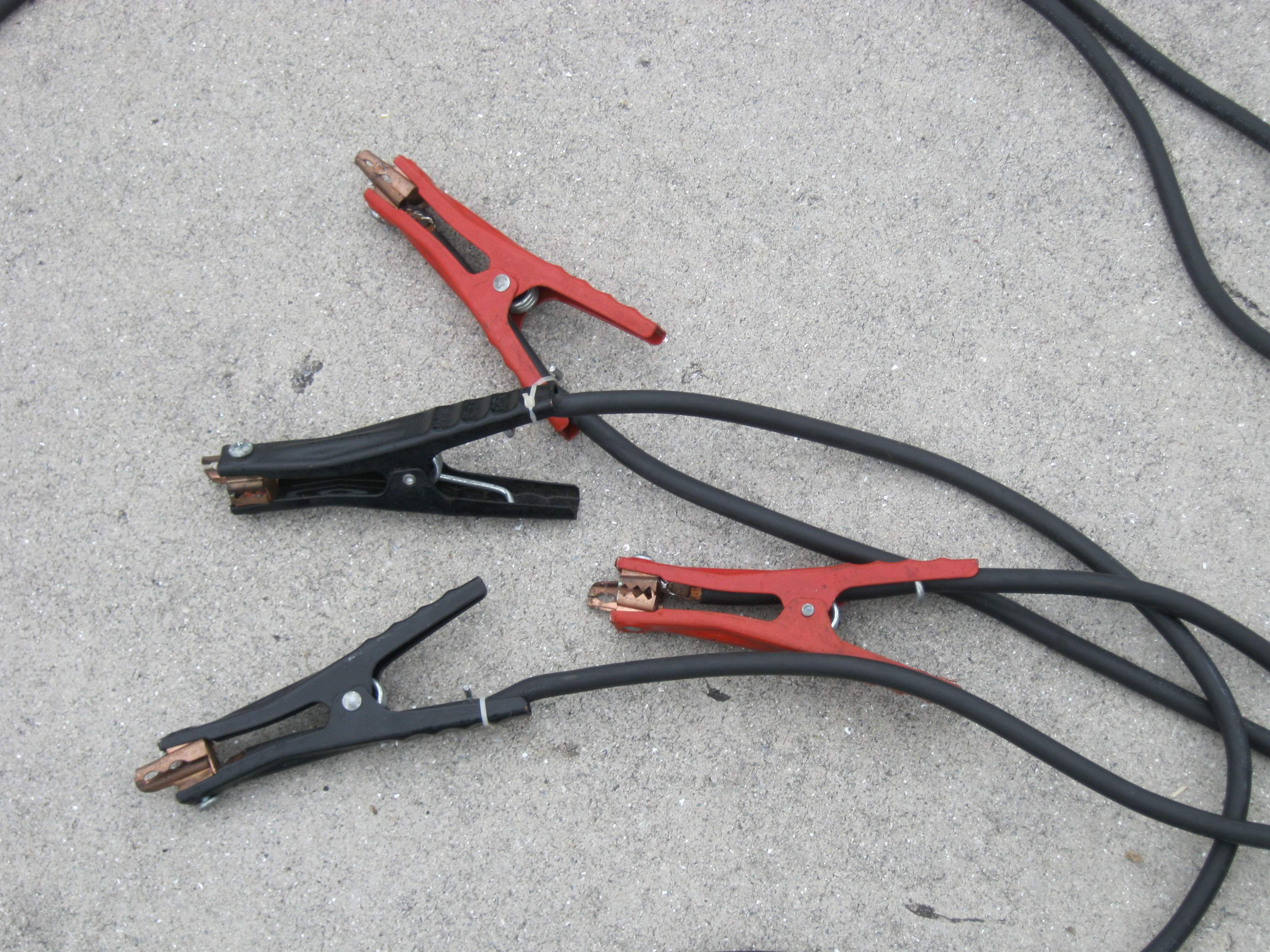

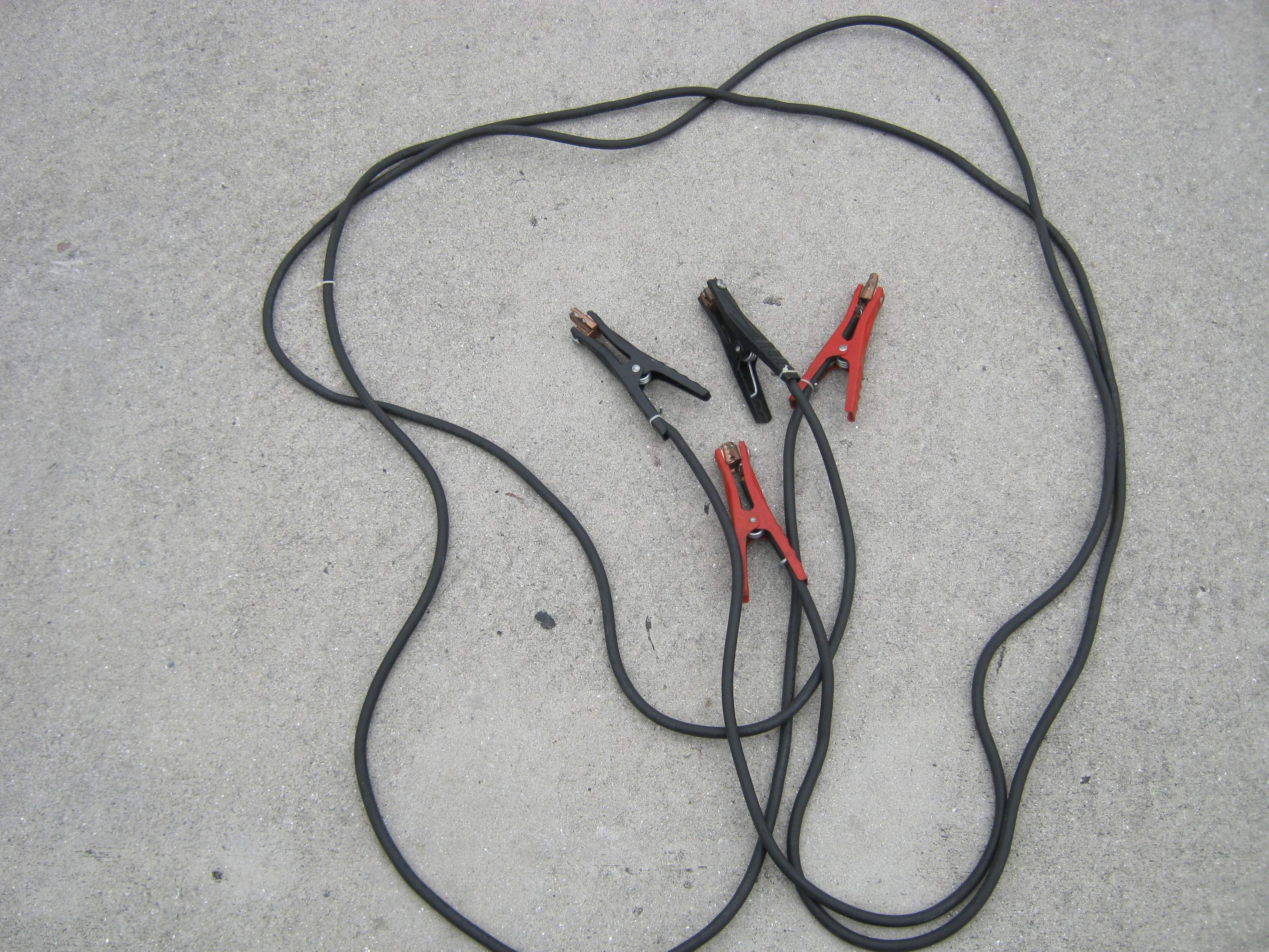

Here's a pair I made from #2 welding cable maybe 15 to 20 feet long.
The ends are clamped down and soldered with big electric soldering pistol. Made them longer also to jump off vehicles from afar in case I have to.Like in parking lots etc.
I have sat and watched people trying to jump start their vehicles with some of those junky skinny wires they sell as jumper cables to no avail. Have come afterwards and told them "you done playing,here lets hook these up and start your car ". Put them on BINGO, fired rite up.
