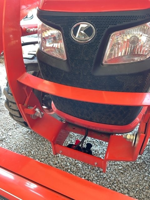

I use a smallish 80a 12v sealed battery. This battery is often used for surveillance equipment which requires replacement every 2 years. And the take offs are good for many more years. A friend used to give these to me. I use them to power 12v lighting in sheds on the ranch. Recharge it every 3-6 mos. It does double duty as it is easy to move from use to use. But most of the time it sits on the fuel tank in the barn.
Initially I too thought I would power from the tractor so I purchased and installed exterior battery contacts. My pump has long leads with alligator clamps. But I find it easier to use the portable battery as not all my diesel users have easy battery access.
