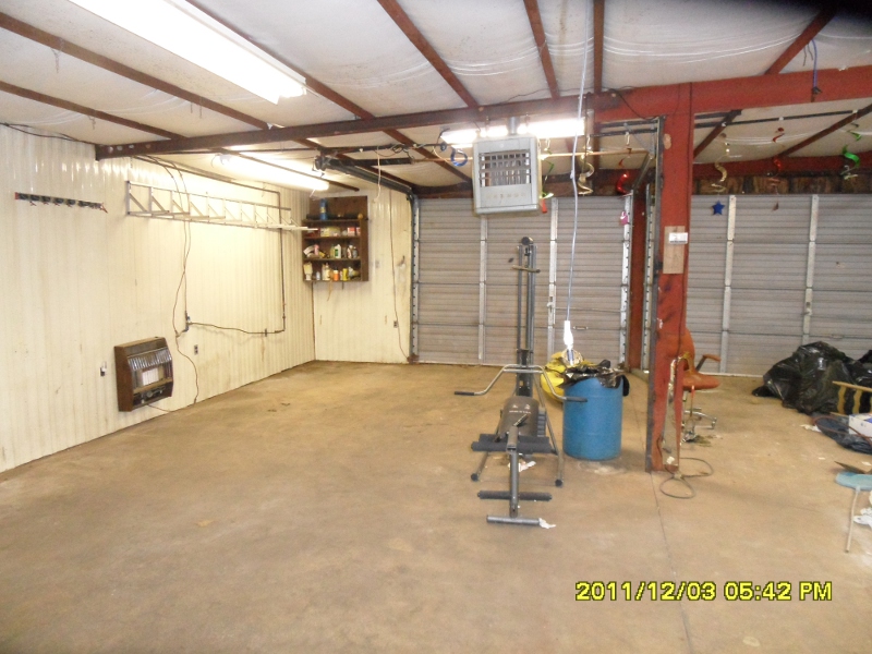

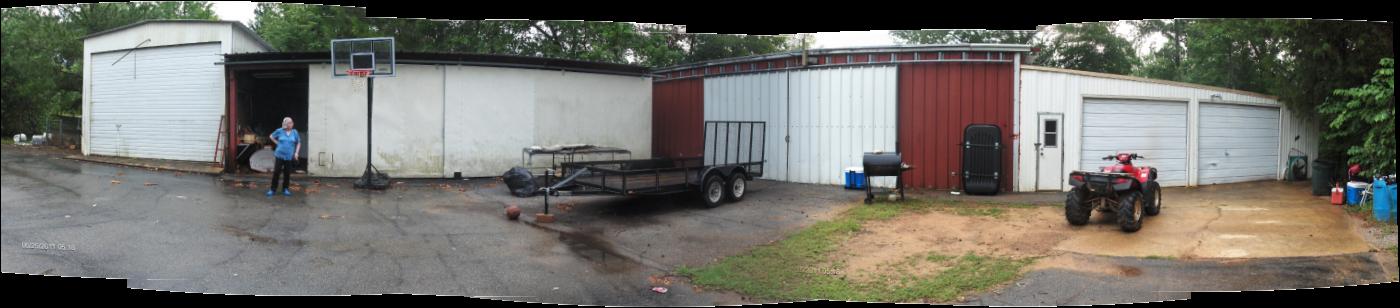

Background -
Workshops
The workshop in the right of center is 40x60 and has an apartment across the back which is about 15x60.
The workshop on the far right is about 30x60 and has insulated walls and ceiling
I've put a 12K BTU window in the apartment and it cooled it down a bit last summer but I knew it wouldn't put a dent in cooling the two workshops on the right.
But at this writing (February 13th) they are at about 38F inside. :)
I've read a couple of threads on here about using geothermal heat pumps (GHP), but they were primarily focused on heating.
I'd like to get some form of cooling to handle the 30x60 insulated shop.
I've got LOTS of land on two sides of the building.
Are there any forum members using GHP primarily for cooling?
What are the economics of GHP for cooling a 30x60 shop to maybe 80F when it's 100F outside?
Do you think I could dig the necessary ditch with my Woods BH70X versus renting a mini-ex for $1K?
Thanks

For starters, my shop is 30 X 60 X 12 and I have it conditioned with a gshp. Dug horizontal loops, 1 with woods bh70x and other with ditch-witch. trencher was much faster! Keep a couple feet separation between loop lines and about 4' of coverage in the South. I am easily able to keep my shop around 80 when outside is around 100. My geo unit has a hot water generator that puts waste heat into my cordless electric water heater tank (never connected the electricity to the tank) for hot water supply in shop. The geo unit is an older EER 15 model that was in my home before I upgraded to a new EER 22 model. New one is much quieter! Shop is fully insulated and am gradually finishing interior walls with 3/4" plywood and installing an additional 8" of fiberglass batts between plywood and existing fiberglass insulation. GHP in shop is only 24000 btu, so it kind of falls behind when I have to leave the roll-up door open for any amount of time. Before I installed it, working in shop during summer was pretty rough. Louisiana can be hot and very humid. Have been told that it only takes 2 to 3 weeks to "acclimate" to a new environment. Not true. I've lived here all my life and I ain't "acclimated" yet!!! My shop elect bill (on separate meter from home) runs around 50 to 60 dollars a month in the summer. Good luck with whatever you decide to do, just very satisfied with gshp in my situation.

Well thanks for all the replies about window units, but I don't have any windows.
LAFarm - could I get more details about your system?
Reads like a match.
What is the length? Pipe size and type? I was concerned about getting it deeper.
That's one of my goals
Great idea!
<snip> Shop is fully insulated and am gradually finishing interior walls with 3/4" plywood and installing an additional 8" of fiberglass batts between plywood and existing fiberglass insulation.
What do you figure is the tradeoff for an extra 8" of insulation? Seems a little like overkill.
Again reads like my situation.
