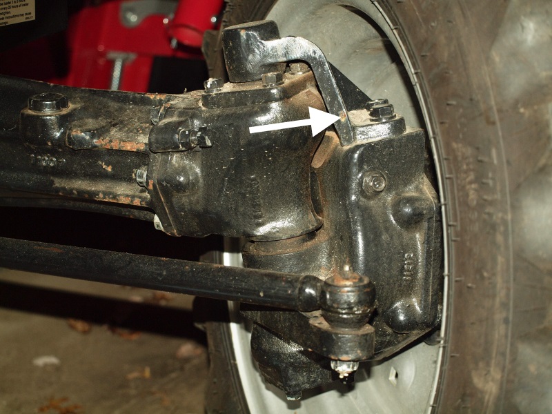

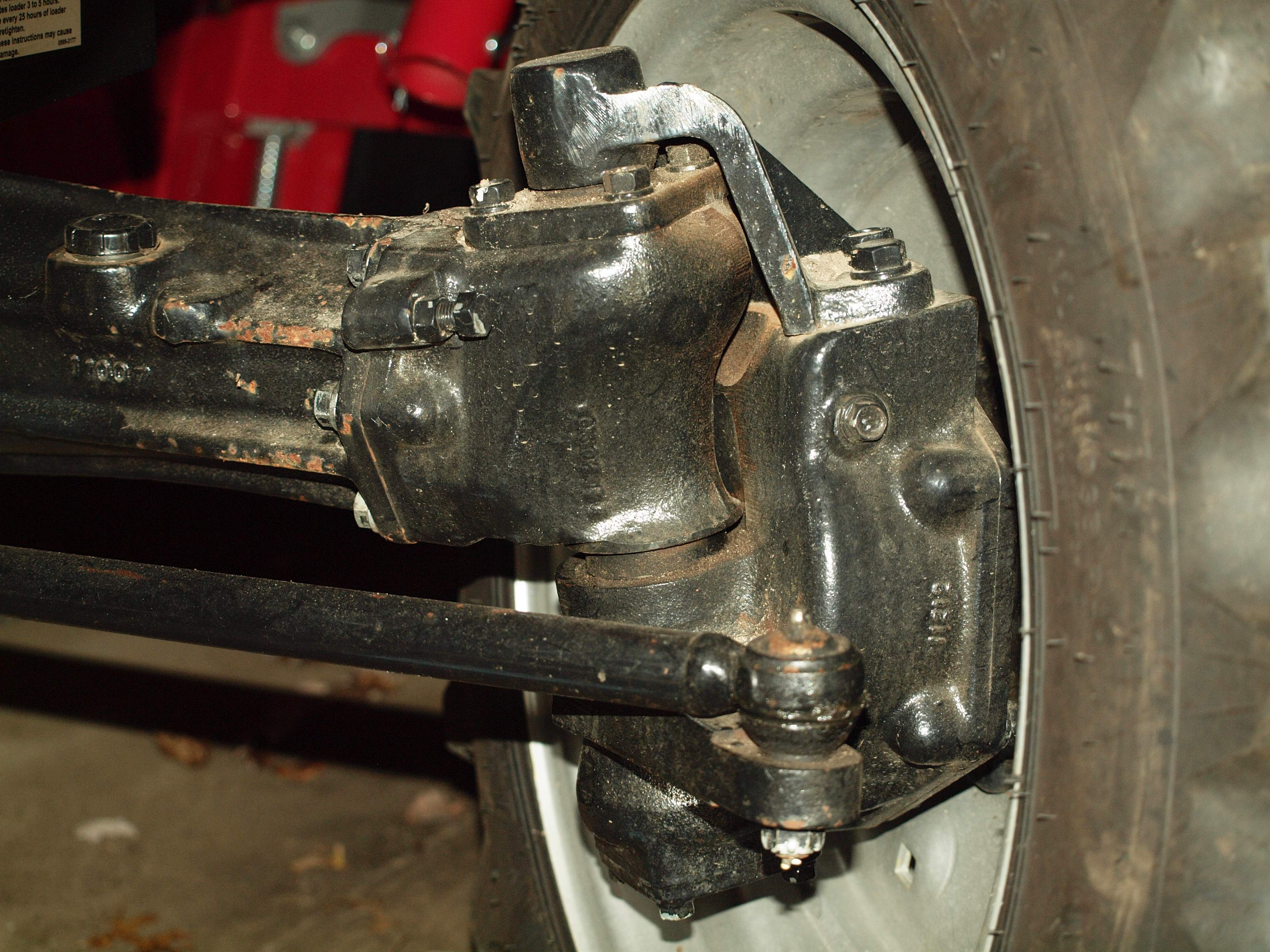

Anyone with a 16 series Mahindra have this bolt sticking out as well? Perhaps it's a fill indicator but I just noticed this. Doesn't seem to tighten much so I do not want to force the issue w/o knowing if it's supposed to be.

Yep, it sets the maximum steering angle. since you moved it, measure the other side and set it the same.
You can see where it contacts the stop here.
