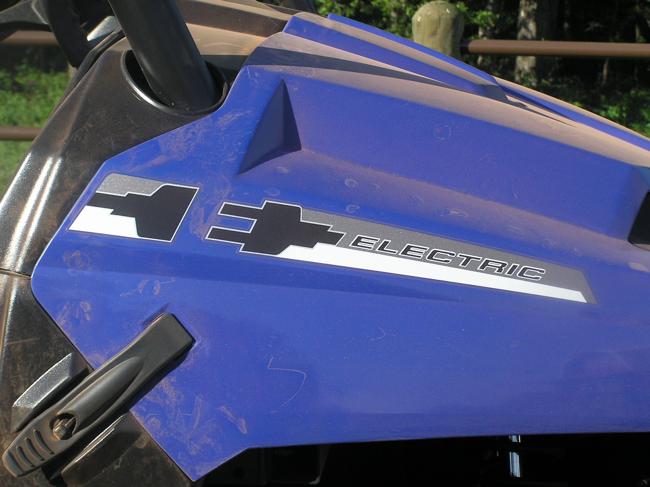

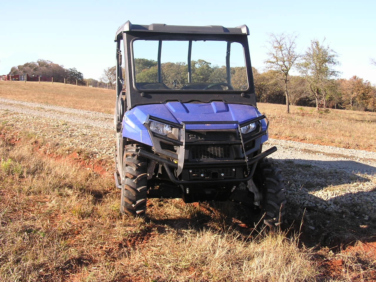

The Ranger EV has Motor braking, it actually charges the batteries when going downhill.
