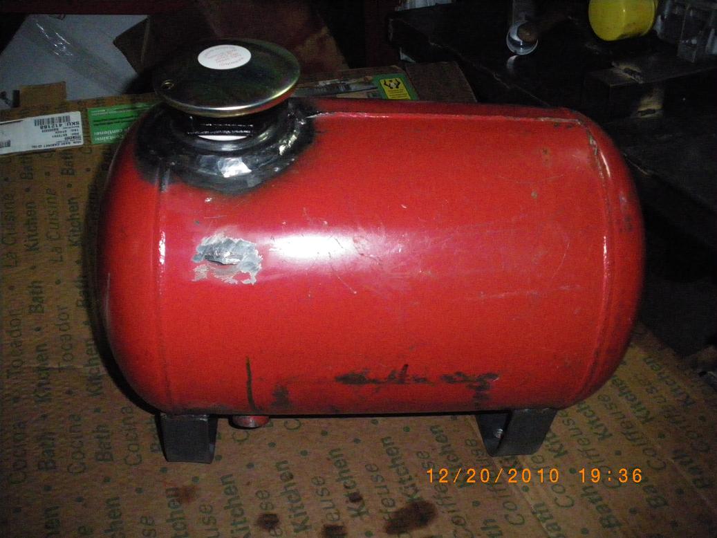

I know water tanks are supposed to be glass lined but I have to wonder, whats more nasty, glass in you hydraulics or glass in your cup of tea? I would go with the water tank, weld on a NPT bung large enough to use a suction filter, this should prevent the glass from getting into the system if there really is glass rattling around in there. You will probably have lots of rust to clean out. You could have four holes in your tank for water, electric heater and pressure relief. You will need an outlet positioned near the bottom and an inlet about 2/3rds up. Without a baffle, I would mount the inlet perpendicular and as far away from the outlet as possible. Also you could consider an old air tank? I used this one to make a gas tank yesterday for my tracked dumper project.

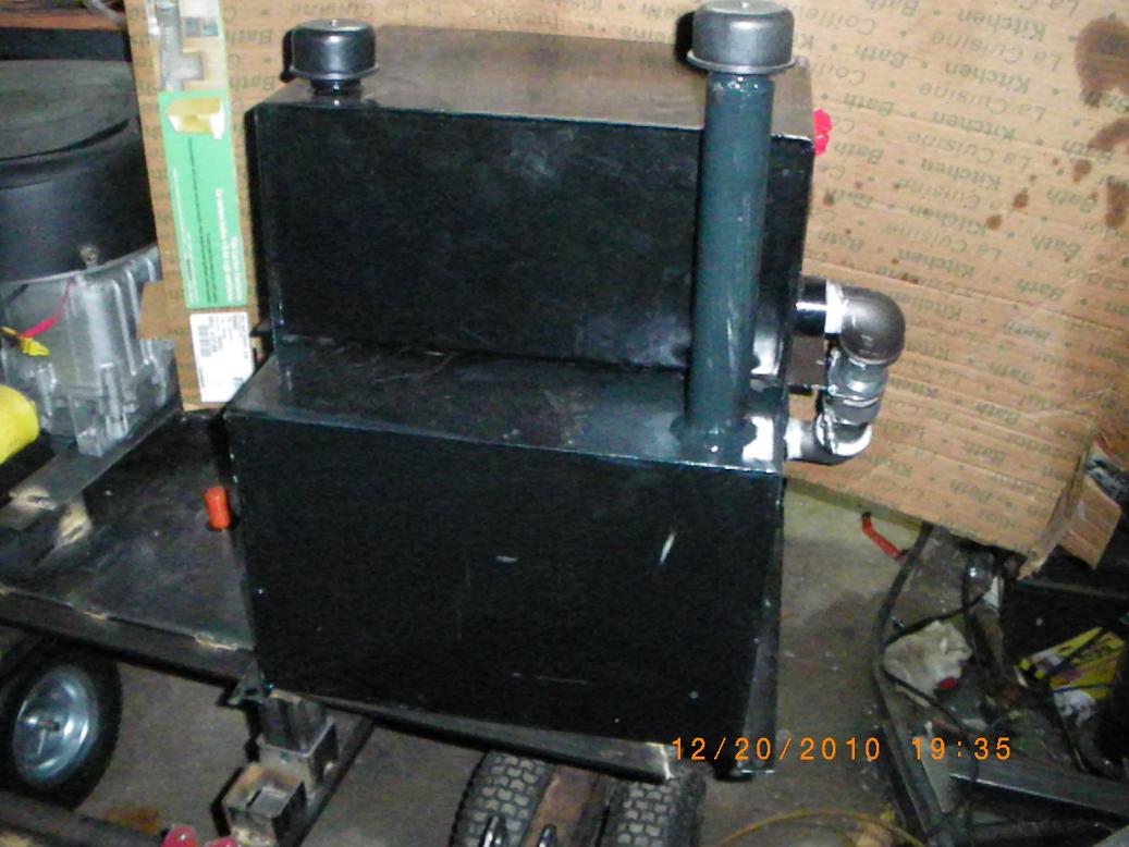

I think I paid only about $90 bucks for my 10 gallon on sale, you should be able to find one not too expensive. Surplus Center had them for 120 bucks. When I was a kid I was facinated with watching the air bubbles in the shampoo bottle float up to the top. The taller the container, the longer it took the bubble to get to the top. So does that mean if you have debris in your system a tall tank is needed and if you have air in your system a shallow tank is needed? I just finished mating a ten gallon and five gallon tank together to get a larger capacity, complete with two air vents etc. One of my concerns is having the system fill the top tank faster then it can flow to the bottom and blow out the vent? Anyway two tanks add some complexity so don't go there if you can avoid it. I had two tanks and a 15 gallon was double the cost of a 5 and 10 gallon together.

That's good to know. I am not all that crazy about adding complexity. I am trying to keep things simple. I need to have a tank a certain size (elongated, not a cube) and Surplus Center got a perfect size. I just didn't look there before. Thanks for the input.
