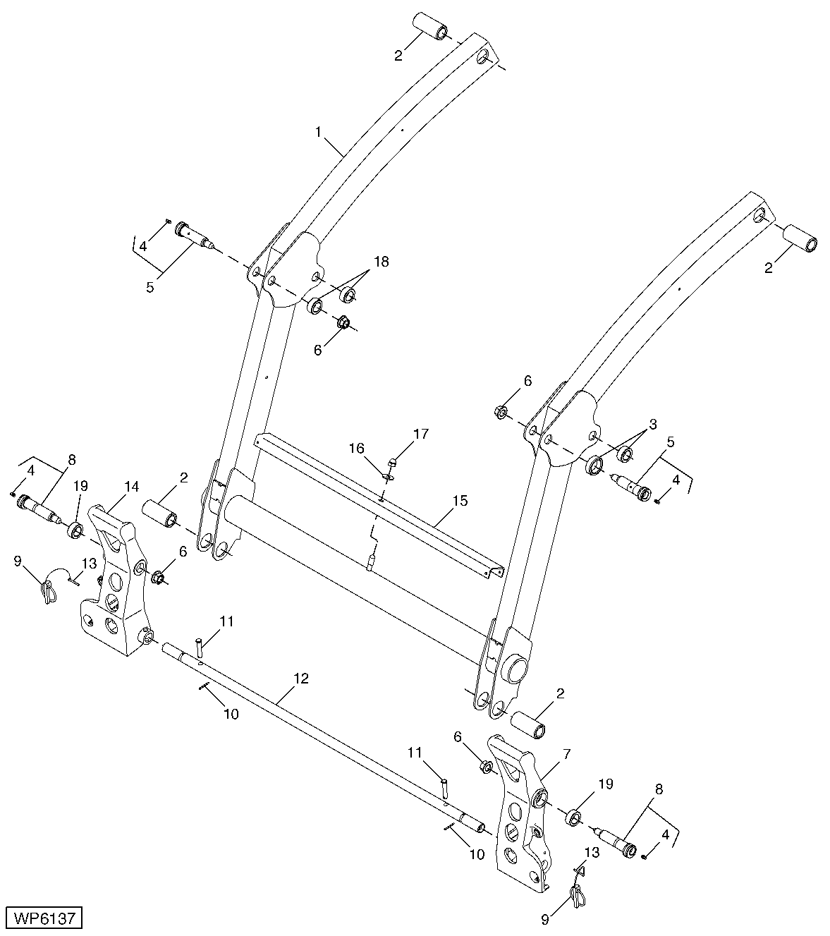

I have a 2305 with a 200CX loader.
When I took the bucket off the loader, I noticed that when extending and retracting the bucket holders (dump and curl) the left side was lagging the right. Both sides are working, but the left side reaches full extension and retraction after the right side. It was getting dark and I was tired so I parked the tractor for the night.

There is really nothing wrong, they do not stay perfectly aligned. There is a tie rod (#12) that runs between the two DA shoes to help keep them "timed", but there is so much slop in the pins (#11) that they still get out of whack. Or, possibly the pin(S) are sheared off.
The picture is below is the 200cx, the 300 is similar:

Kennyd is right.
They will get a little out of alignment. As you try to attach back onto your bucket, you may have a problem with one in proper postion and the other too far back. Just push the bucket a bit with your loader. This will push your FEL carrier back into proper postion. Then hook on.
If you alignment is way off, then you have probably lost or sheared off one of the pins in the tie rod connecting the 2 sides.

Just a follow-up.
Sure enough, I was missing the left clevis pin (#11) on the loader.
Thanks again
   / What's wrong with my loader? #9
Reading the posts here made me look things over more closely. At what I call the top of the masts there is an assembly that allows you to flip a lever in order to take the loader off the tractor. I noticed a large bolt with the head against the mast on each side of the loader. Of course I had seen them before but thought they were parts of the loader-release-from-the-tactor (not sure how to word that) assembly. One was out about a 7/32nds more than the other. First measured bucket from level floor, had 3/4 inch diff side to side. Measured cylinders and had 1/2 inch diff in extensions. Turned the bolt in on the side that was lower. The bucket started to come level. Kept at it until almost level and stopped. Then extended and retracted all cylinders completely several times and they also now match as far as rod distances. Not sure if what I did will affect any of the other alignments so did not worry about perfect level and know that there is some slop in the pins. Those bolts are not on the diagram posted earlier but it sure is nice to have that printed out for future reference. I thought I would post this just in case someone else had run into this. Thanks to everyone:)
