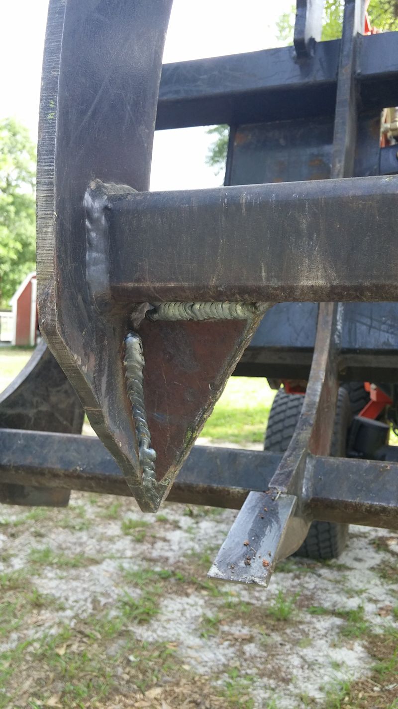

I had both of the corners on my grapple bend into a "J" shape when a person I hired was picking up tree debris with the tractor. I don't believe he did anything to cause the issue, and my only reason for mentioning him is he "knew" a local welder who would bend them straight and add a support for a reasonable fee. The guy was supposedly set up as a mobile service, but when we contacted him, wanted us to bring the grapple to him. Again, not big deal as it was maybe a 4-5 mile trip to his home.
So, you can see what he did-- Heat the corners, pound them straight, cut two pieces of steel for a gussets, and weld them into place.
My question is what you might consider a reasonable fee to pay for this. I will post up what I paid after I get a few responses on this. I have some other work I need done and will judge my best options for who I get to do it once I figure out how reasonable his charges were.

Should have had the gussets there in the first place. My grapple does. Around here welders prices vary a lot but all do quality work. I propably would have it done for around $100 which I would expect is a minimum charge.

My thoughts from looking at the weld is that he is not that good of a welder and $40 per hour would be highly overpaid especially if he has a minimum of 2 hours. Material cost would add to that figure also.

Well, I appreciate the input from all. I agree that it should have had the gussets originally, but I didn't know enough about what to look for when I got it several years ago. I don't weld so I can only compare it to what the weld looked like that was used to put on two hooks on my bucket, which was a $60.00 job and the $130.00 this fellow charged me looked like. to be honest, the weld on the bucket was a nicer looking weld, but as long as this stays put, I will be happy.

My guess is it will break! It's a neat weld but I'm thinking that there isn't much penetration. I could be wrong. At least you didn't get royally ripped off in the money department. I guess a guy has to eat, even if he isn't the best at what he does.

If you were 4-5 miles from me I would have come to you and welded it for that price and I would have done a nicer job. He didn't do a very nice job or even paint it
   / What's your opinion? #10
I have to agree it's a pretty poor job for $130. I'm sure someone with experience could have fixed both sides in an hour or less and it would look a lot better.
