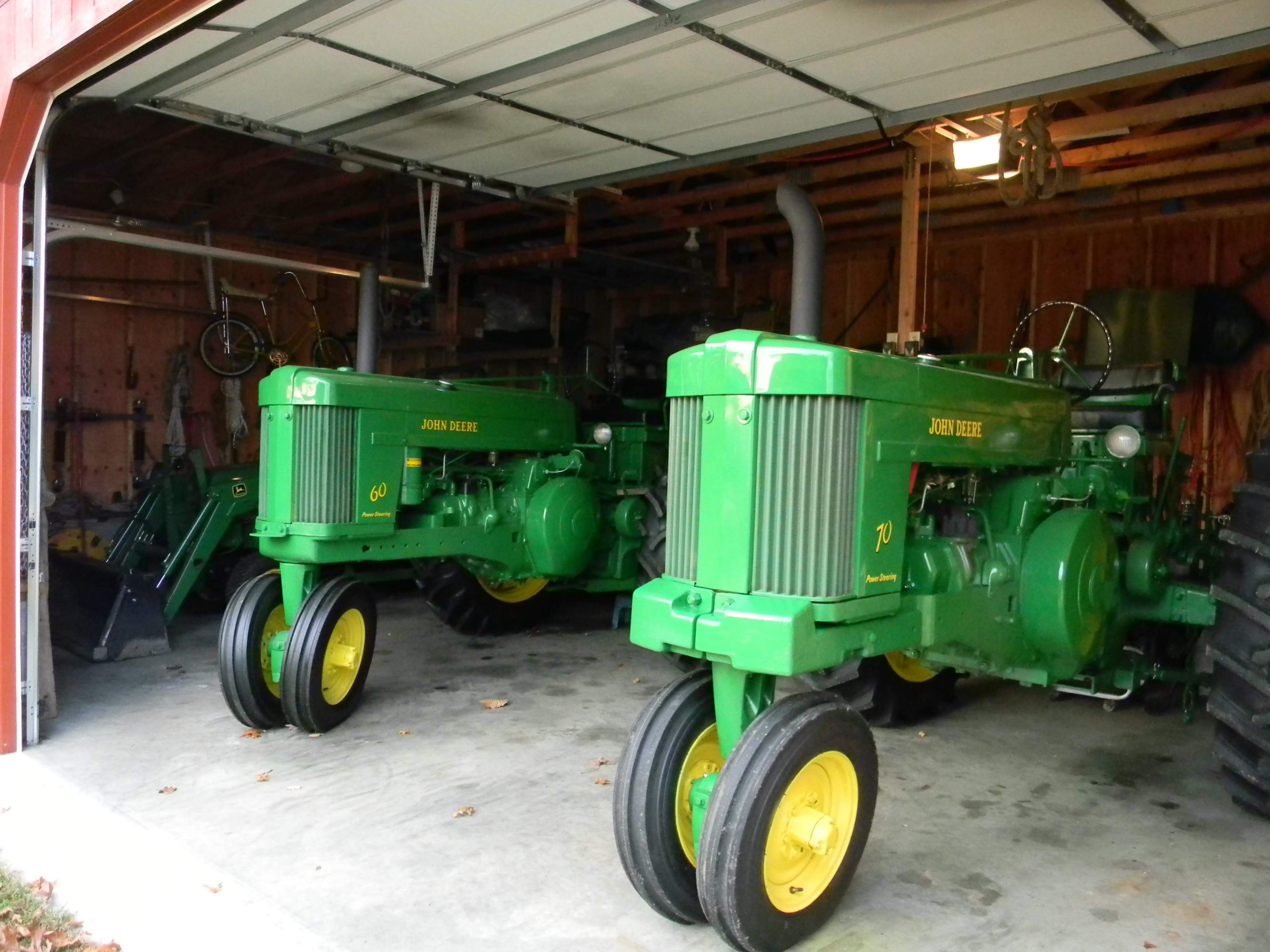

And,,,,, pictures of your tractor please??? Tractor pulling used to be a very big deal around here, especially in the Vintage classes. Seems to have died out a bit but the participants are very dedicated.
   / Wheel and Tire - Tractor pulls
Windham,Maine. Am dedicating the newly restored 70 for pulling, the 60 has already put trophy's in the barn. Pulling popularity around here is strong I guess just about all the fairs allow our club to put on a show. We can choose to pull on dirt or concrete I prefer dirt.
