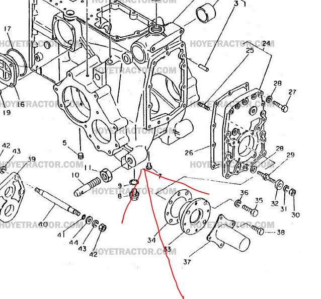

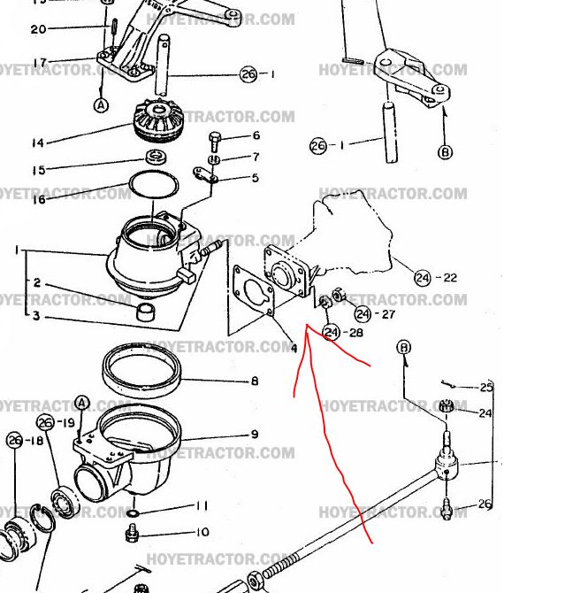

I don't think there is really any specific location. If you are only jacking up one wheel at a time I would just put the jack under the lift arm pin area in the rear and on the front I would just put the jack under the axle casting on the one side. Just don't ever get under it and use jack stands when possible. Those tractors are small but extremely heavy.
