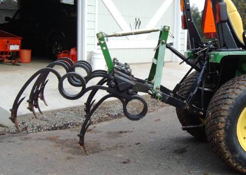

I did it on an old JD M soil ripper. It's a much lighter weight than a wheeled disc.
Here's a pic.
Ralph

Go for it! And post pics.
I bought an old Graham Hamey (?) 12 ft pull type chisel plow years ago. I needed about a 6 ft chisel for my 40HP Ford. Did the same thing as you are thinking.
Paid $40 for the unit at auction, torched it apart (mostly) at the auction site, hauled it home and used parts of the frame for the 3PT hitch.
A guy at the auction came up afterward and gave me $20 for the two outside extension shanks that would go on his unit. Sold the left over iron for scrap, and ended up with a NICE 6 shank 3PT chisel plow.
I had my eye on an old old OLD pull type disc--the kind you pull a level and it changes the gang angles, but it didn't have the frame needed to make it 3PT--and it sold anyway before I got it.
Have fun. And if it looks like crap when you are done, tell people you bought it that way! If it looks good, tell 'em you did it!
