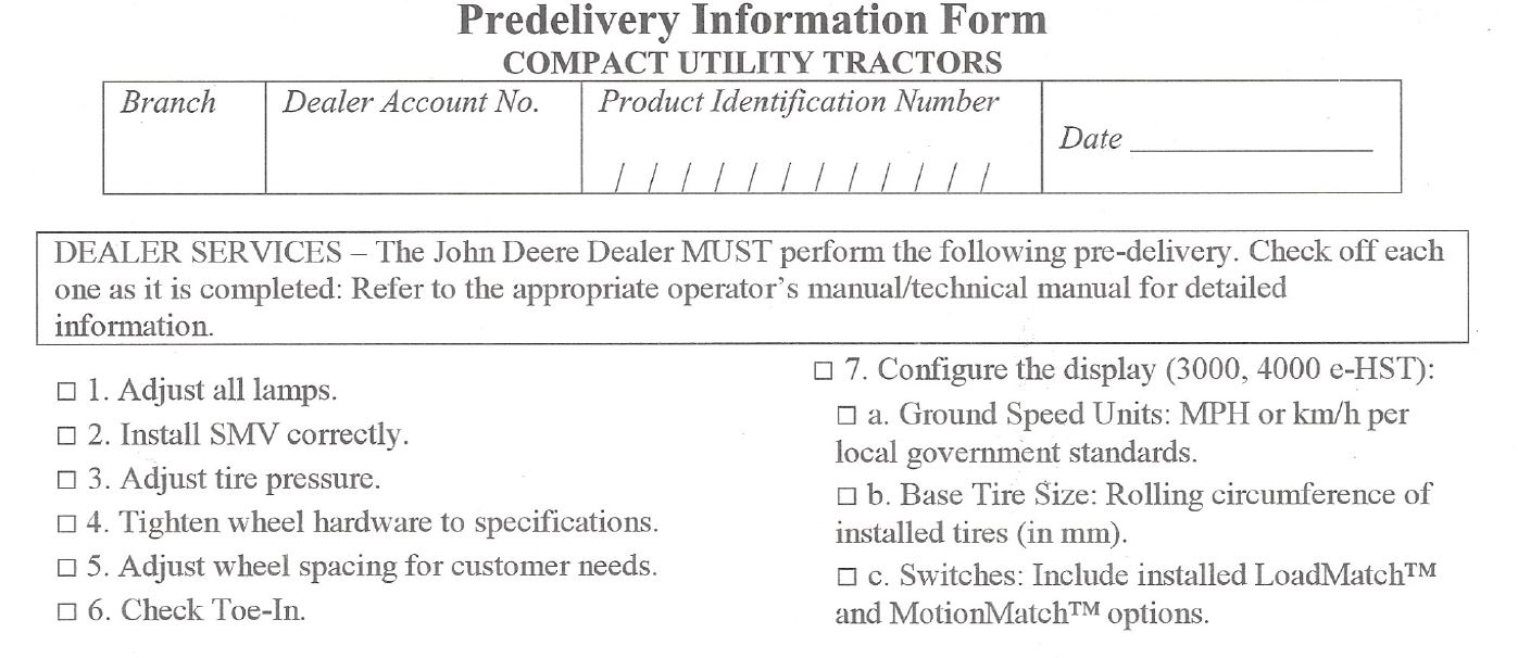

I would hope (Expect) the dealership to go out of their way to fix the issue and compensate you for the headache, just give them the opportunity. Attached is a snapshot of the dealership check list that was in the back of my owners manual. Good Luck.
That's on a new machine, when i bought my used 07, they were checked off from the 1st time buyer.
