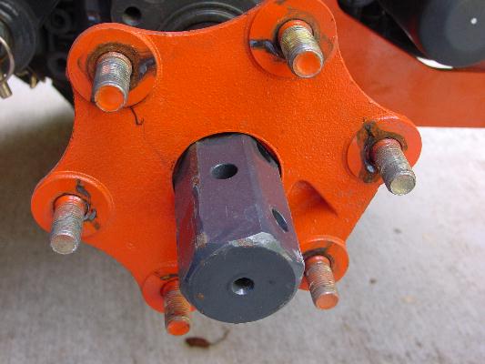

Photos attached. I pulled the wheel and examined the bolt flange - shiney metal can be seen where there is slippage. Look carefully and shiney spots are there
Also, the big flange bolt was loose on the right side.
The flange bolt can be accessed without pulling the wheel.
Kubota's manual requires torque checking the wheel bolts a specific intervals. My tools are inadequate to really tighten up the wheel bolts. Guess I'll make a pit stop at Harbor Freight for some half-inch drives. (By the way, that flange bolt is a 7/8th's inch socket - same as the wheel bolts.)

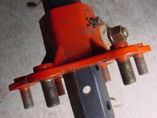

   / Wheel noise..errrnt, errrnt.... #9
Closer look -

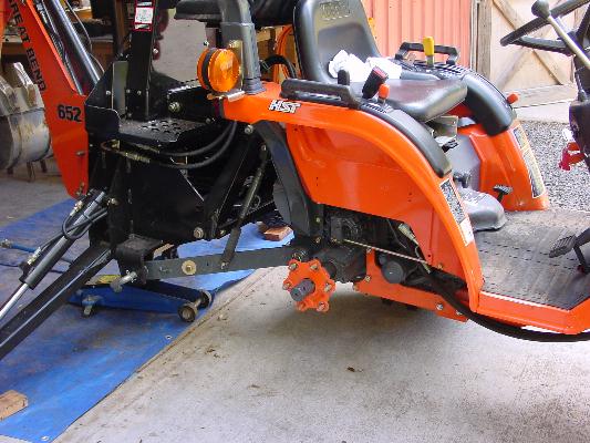

   / Wheel noise..errrnt, errrnt.... #10
Flange bolt -
