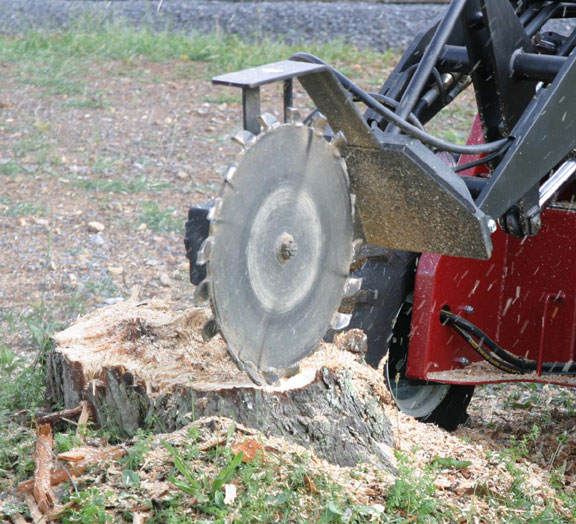

Here is a picture of the one I have.
It can be used as a stump grinder or as a wheeled trencher.
The wheeled dirt-trencher below was not available when my 1990's PT-1445 was sold.

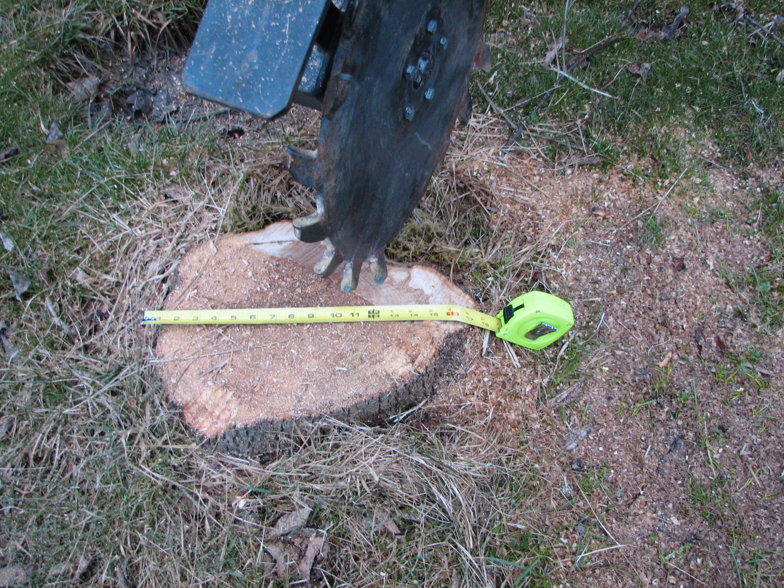

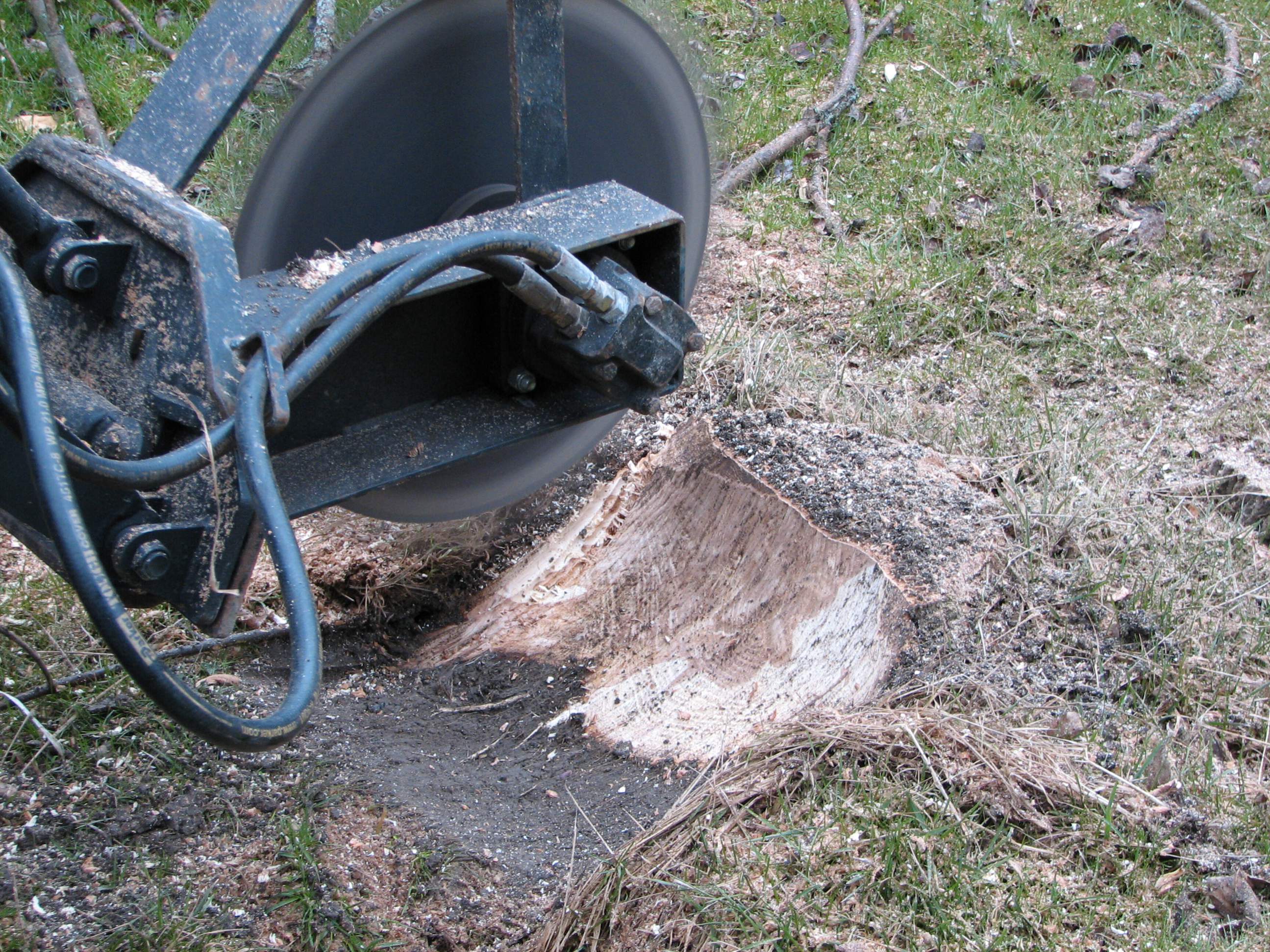

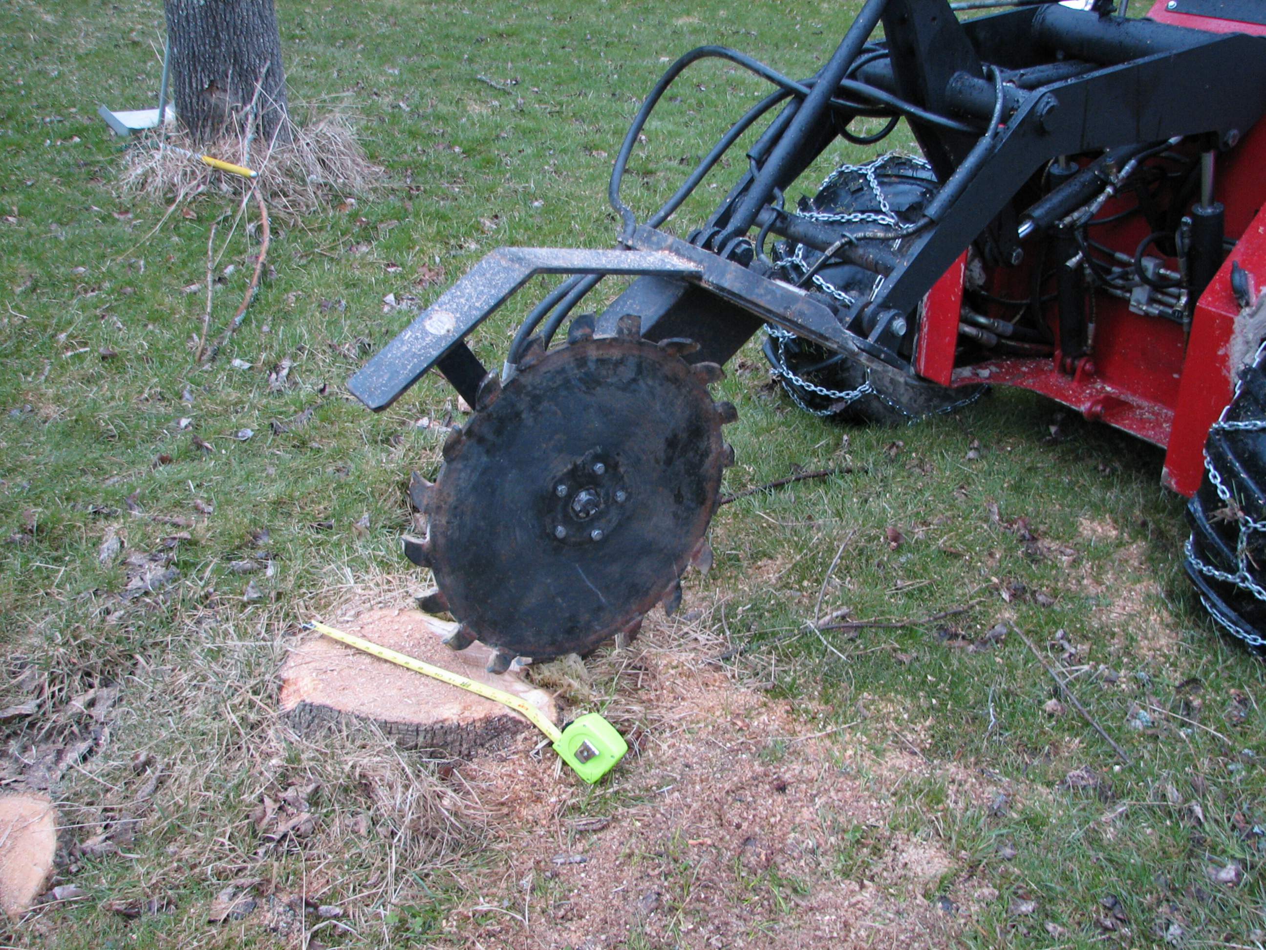

Still looking for some close up shots of the wheel trencher. I would like to see how the motor is mounted to the plate.
   / Wheel Trencher #7
Here are some pictures of my stump grinder for what it is worth:
Ken

Can the PT wheel trencher be used for grinding stumps? If it can cut asphalt, I would think it could cut wood.
   / Wheel Trencher #16
I cut stumps with my trencher/stump grinder.
Need sharp teeth. Use green stone to sharpen.
   / Wheel Trencher #17
J.J.
Yours actually is a PT stump grinder, right? I was wondering if the PT wheel trencher could go the other way and be used for stumps.
   / Wheel Trencher #18
Mine was advertised as a stump grinder, but I have cut many trenches with it.
   / Wheel Trencher #19
The PT stump grinder is 18" in diameter and is advertised as also being able to cut trenches up to 6" deep. The PT wheel trencher is 26" in diameter, I believe, and is not advertised for stump cutting, but it is advertised for asphalt cutting. I spoke to Terry today about it. He was not sure how well it would work one way or the other. The teeth on the both attachments are the same. He said the motor on the WT was larger and had more torque than the one on the stump cutter, but the SC turns faster. I noted that the larger diameter on the WT would increase the speed of the outer edge of the wheel more than the same effect on the smaller SC wheel. He didn't know the RPM of either attachment. So who knows? Maybe the teeth would hit the stump at about the same rate with either attachment. My reason for looking into this is that I plan to buy my PT 425 in early November and am fine-tuning my attachment list.
