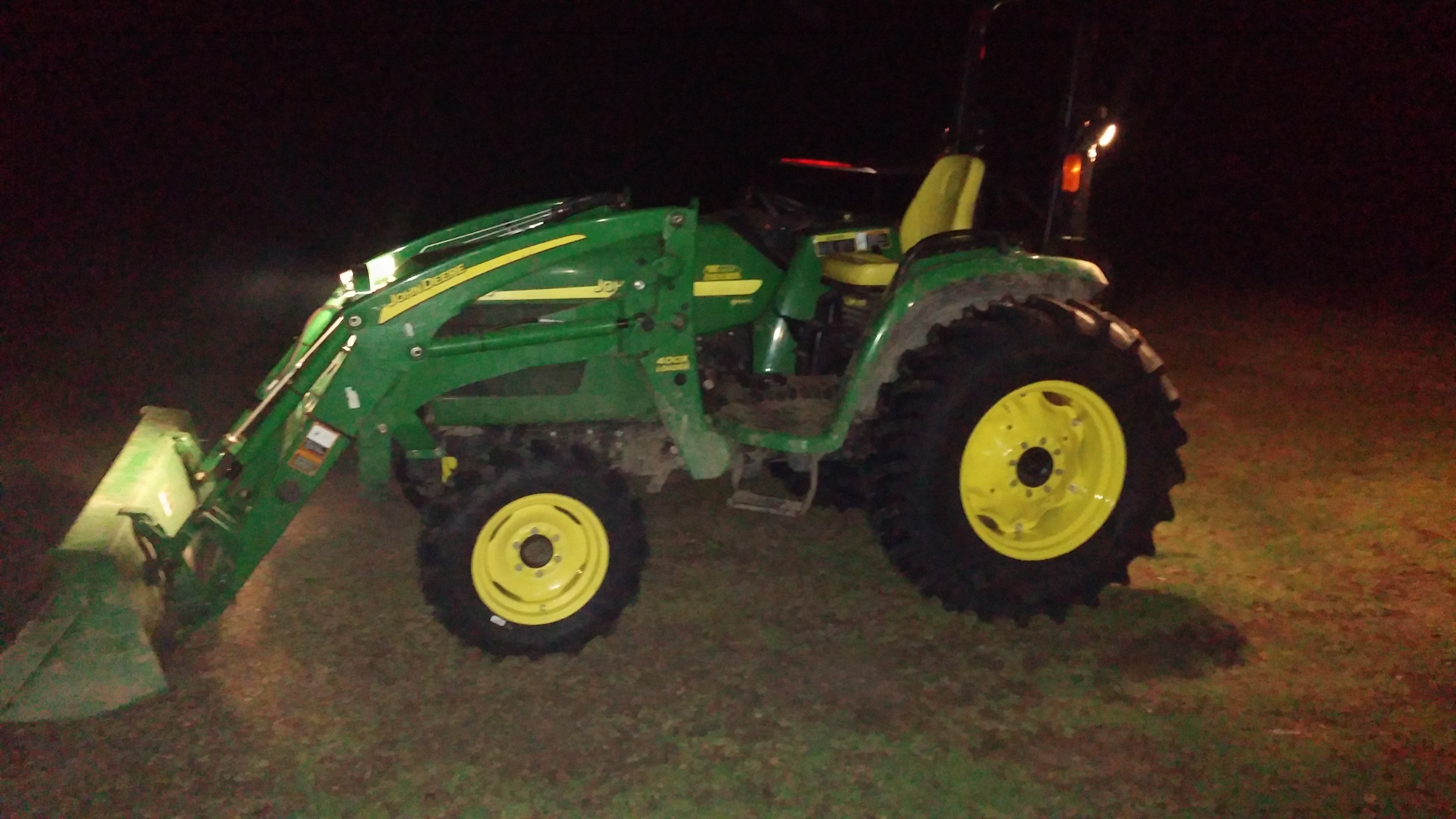

I put Unverferth 24" wheels on my John Deere 4610 last fall which include a stamped center . I was very happy to buy an American made aftermarket part, but there is very little data available for these online.
Now, I need rear wheel weights and I'm not sure if the Deere OE part (T19293) will fit. The wheels have 4 square holes for carriage bolts, spaced 13" apart diametrically, as best I can measure. It's difficult to measure, since the wheel is dish-shaped. Does anyone know what the wheel weight hole spacing is on the Deere wheel? The Deere wheel is T19638.
I really don't want to buy these, and pay freight, only to have them not fit, you know?

JD parts spec's doesn't list spacing for holes that are intended to attach weights.
   / Wheel weight hole spacing - Unverferth and Deere #3
IIRCC T19293 has two sets of four mounting holes. each set is on a different size bolt circle. The holes are also slots/elongated, so you have a little play. The outer bolt circle is approx. 15.5" the inner bolt circle is approx. 12.7"
Instead of measuring diagonally, try measuring hole to hole. If you get 8 1/2 - 9 inches you should be OK.
I think those weights are used for both 4xxx series and 5xxx series tractors. Maybe post a question to those owners asking for a measurement
