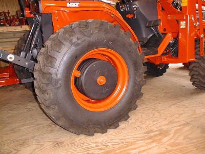

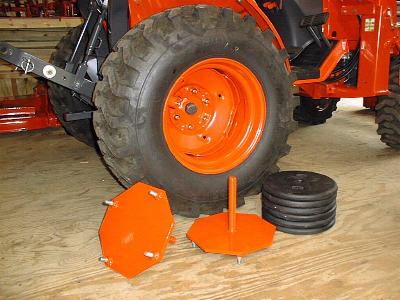

By Andy on Sunday, December 20, 1998 - 03:19 pm:
I am enclosing some photos of the rear wheel weights I made for my B2400. The Mounting plates are 1/2" steel plate with 1/2" bolts welded on the back. The center mount for the weights is 1" threaded rod. The brackets can be left on the wheel all the time (although they are easy to remove) and the weights slide on and off quickly. The weights are 25 lb weight lifting weights that cost 39 cents a pound. The brackets weigh 15 lbs each, there are 6 weights on each wheel for a total of 330 lbs. Hope this works, it is my first try posting images.
   / Wheel weights on kubota tractors? Who has them? #3
Another

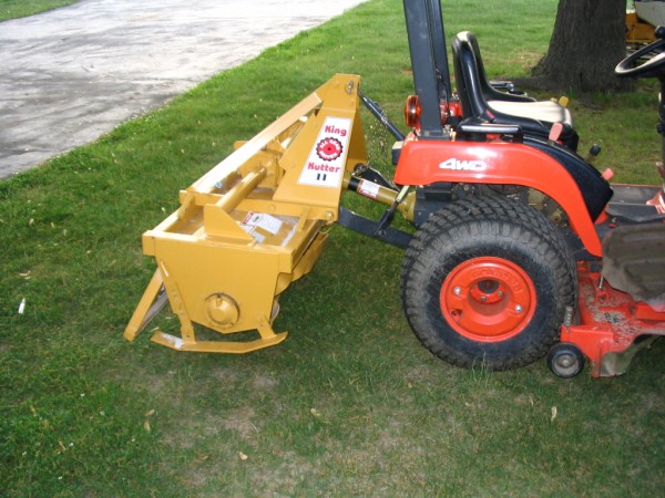

I have the old Bolens ones that were on my Cub Cadet. The diameter of the rim was the same and all I had to do was get longer bolts and paint them Orange. I use rear ballast when using the loader, but the wheel weights are nice for mowing and some extra traction at times.
I don't have filled tires either for the record.
You can see one in this photo.
   / Wheel weights on kubota tractors? Who has them? #7
Sorry to stray from the topic but what size King Kutter Tiller is that in the pic?
