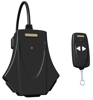

anyone use remote switching
http://www.tscstores.com/TIMER-3-OUTLT-OUTDR-W-REMOTE-P17002.aspx
My problem is that my barn/garage is maybe 700' away, yes I am looking for the easier softer way. I would use x-10 but it has been known to do strange things on power outages and such.
I use something similar but only has one outlet that is a heavy duty version designed to light up christmas displays. Works very well. I am only around 50 feet from that tractor garage and I also put a two way splitter with an outside light so when I turn on the block heater the outside light also lights (letting me know the on command was received and it is powered on). I also run mine for one to two hours and only in the winter months when it is below 30 degrees.
I actually start the tractorafter the hour or two with the block heater still on to aid in warming. I let it warm up for about 10 minutes, unplug the heater and then slowly work the tractor to heat the hydraulic oil and drivetrain.
The light idea is good it lets you know if you forgot to turn it off too.
