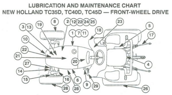

Where are the locations of any zerk fittings on a 2002 TC40?

They are easy to find on the 16LA loader, bucket grapple, front end and the one on the 3-point hitch angle adjustment crank but are there other zerks on the tractor that I have missed? This is a 12X12 manual transmission.

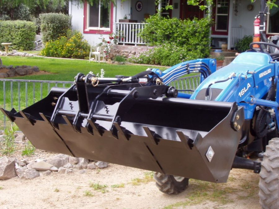

Attached the photo just to show my custom designed grapple that in itself has eight noticeable zerk fittings.

This could be what I'm looking for but it is centralized around 2003 DA models, none of which are mine but it's worth a look-thanks seville009.

Climb under and have a look. The manual looks to be correct for my who-knows-when TC40DA, so as long as you have supersteer it will be the same.
I also have a zerk on the HST pedal pivot, the brake pedal pivot, and two on the manual height adjust on one three point arm.

For load bearing pivots like the front axle (hardest zerk to find?), I try to take the load off with a hi-lift jack before greasing. That way the lube gets where it is needed.
