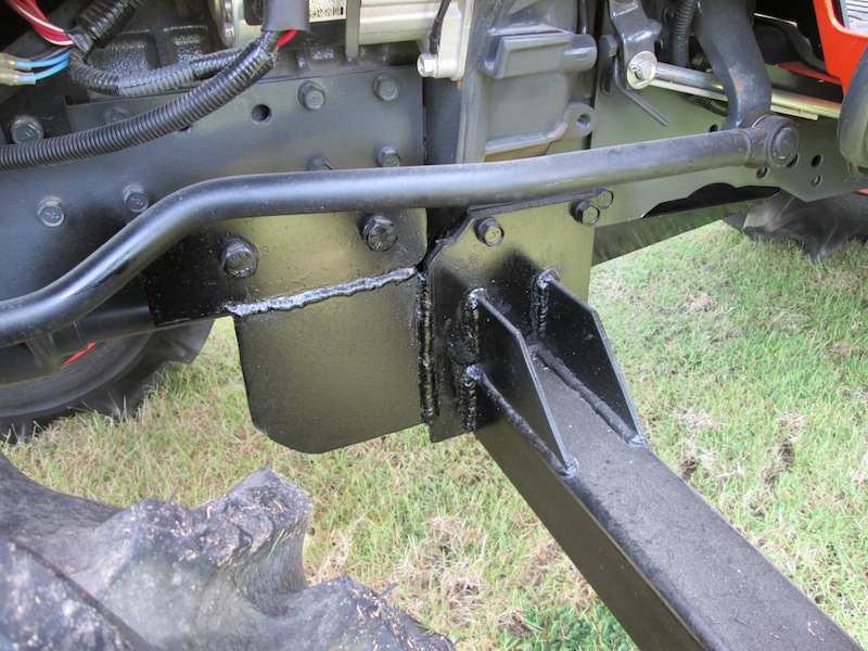

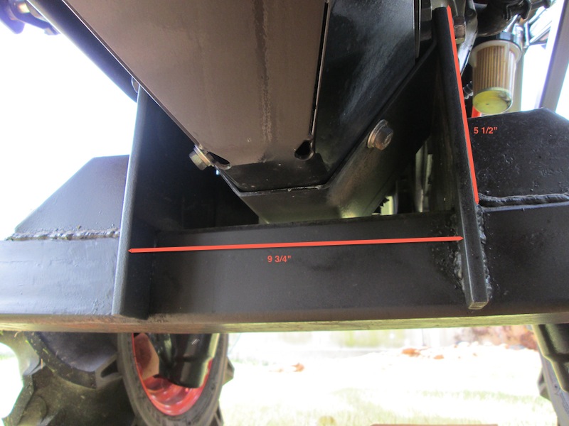

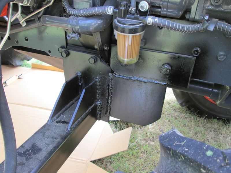

I hear you. Coldwater did not have one for my Kubota B2420 either. To be more precise, they had not made one for my tractor before so could not finish the fabrication on the bottom bar and bracket that goes under the tractor as Coldwater did not have the proper measurements. They did send me all of the pieces I needed to fabricate my own, some drawings of how it should be mounted and a few photos and once I found a welder to do that part for me, it came together quite well.

Yes, everything was complete with the exception of where the bottom brackets are welded on to the square bottom tube that runs under the width of the tractor. Coldwater shipped everything to me in Thailand at a cost of $2,300. $1,800 for the FEL and an excellent deal on the sea freight of $500.
Photos below of the parts that required welding at my end.
