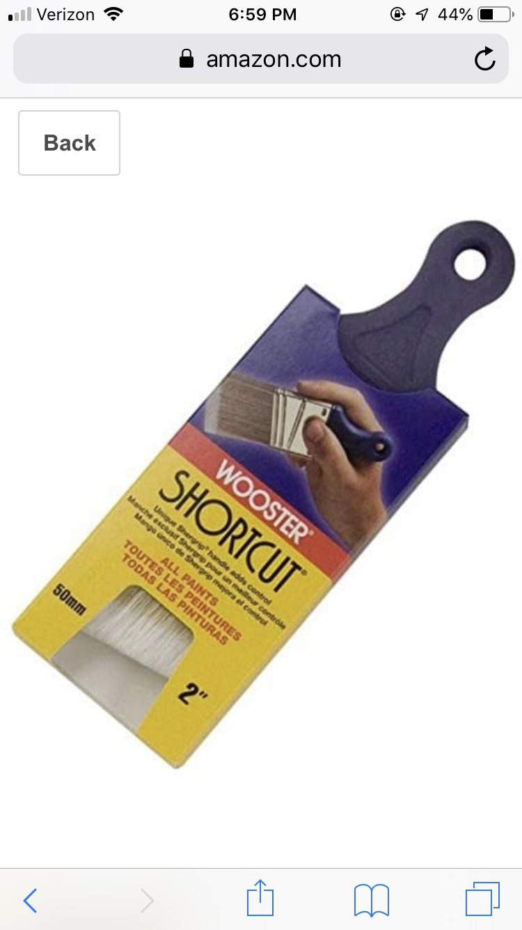

A wood handle brush cramps my hand pretty quickly. I’ve started using stubby rubber handle brushes and found them to be much more comfortable. Also if you’re using a roller head by itself you’re doing it wrong. A 2-4’ pole will make your job much easier.
