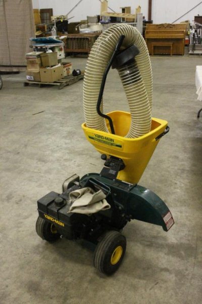

I have a 4' x 8' trailer that I liked to adapt into leaf vacuum trailer that I tow behind my riding mower.
(the type where the mower deck blows the leaves through a tube to a motorized impellor that sucks/blows the leaves to the cart)
I see it's easy to find the tubing and the attachment to the mower decks, but does anybody know where can I find the motorized vacuum/blower unit that I could mount on the tongue of my trailer?
   / Where can I get power unit for a "leaf vacuum"? #2
I think you could buy it as replacement parts from any of the yard vac manufacturers. However, it seems to me you would be better off just buying a used unit and fixing whatever it needs. Around here there are usually used ones on CraigsList for 25% to 50% of the new price.
   / Where can I get power unit for a "leaf vacuum"? #5
I did the same thing a few years back with a yardman chipper shredder. Worked really well. Where are you located? I sold the tractor but still have the chipper. Haven't used it for years. 18751056.jpg 18751056.jpg
