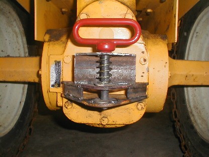

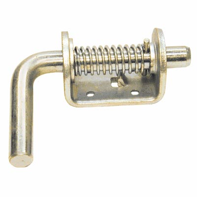

OK all you DIY's; I found this in Northern but I'm really looking for one with a longer throw. Any ideas?

From McMaster-Carr, of course.
Link
MikePA: Cleaned up long URL. Please review your message before posting it. It's simple not to do this. Just insert a descriptive word or two between the {url=http://whatever}<font color="red">Enter words here</font>{/url} instead of the entire URL. Replace parentheses with brackets in previous example.
You will have to add the spring yourself, it looks like.

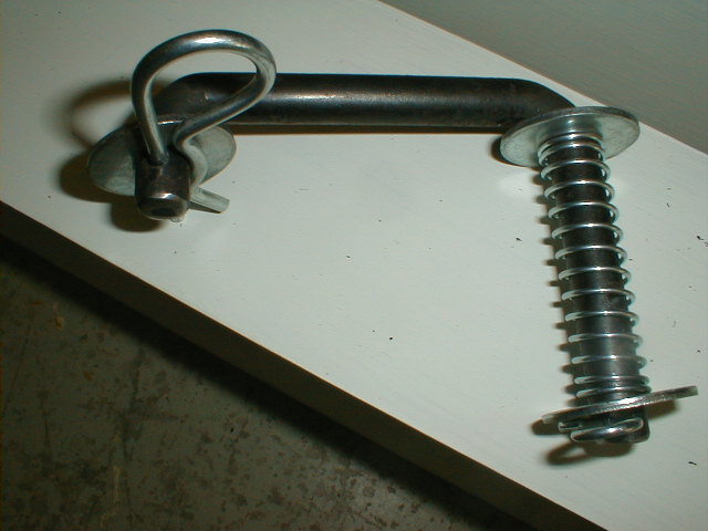

You can always make one to suit your needs...there real easy to make.

They really are simple and fun to make. The attached pic is one I made for my trailer. I used a 1/2" anchor bolt, clamped it in a vice then heated the bend area red hot and made a simple 90 degree bend. Next I cut to length, drilled the holes and added a spring.
The big advantage of making it yourself is you get exactly whats needed for the intended purpose, and like I say its fun! /forums/images/graemlins/grin.gif
