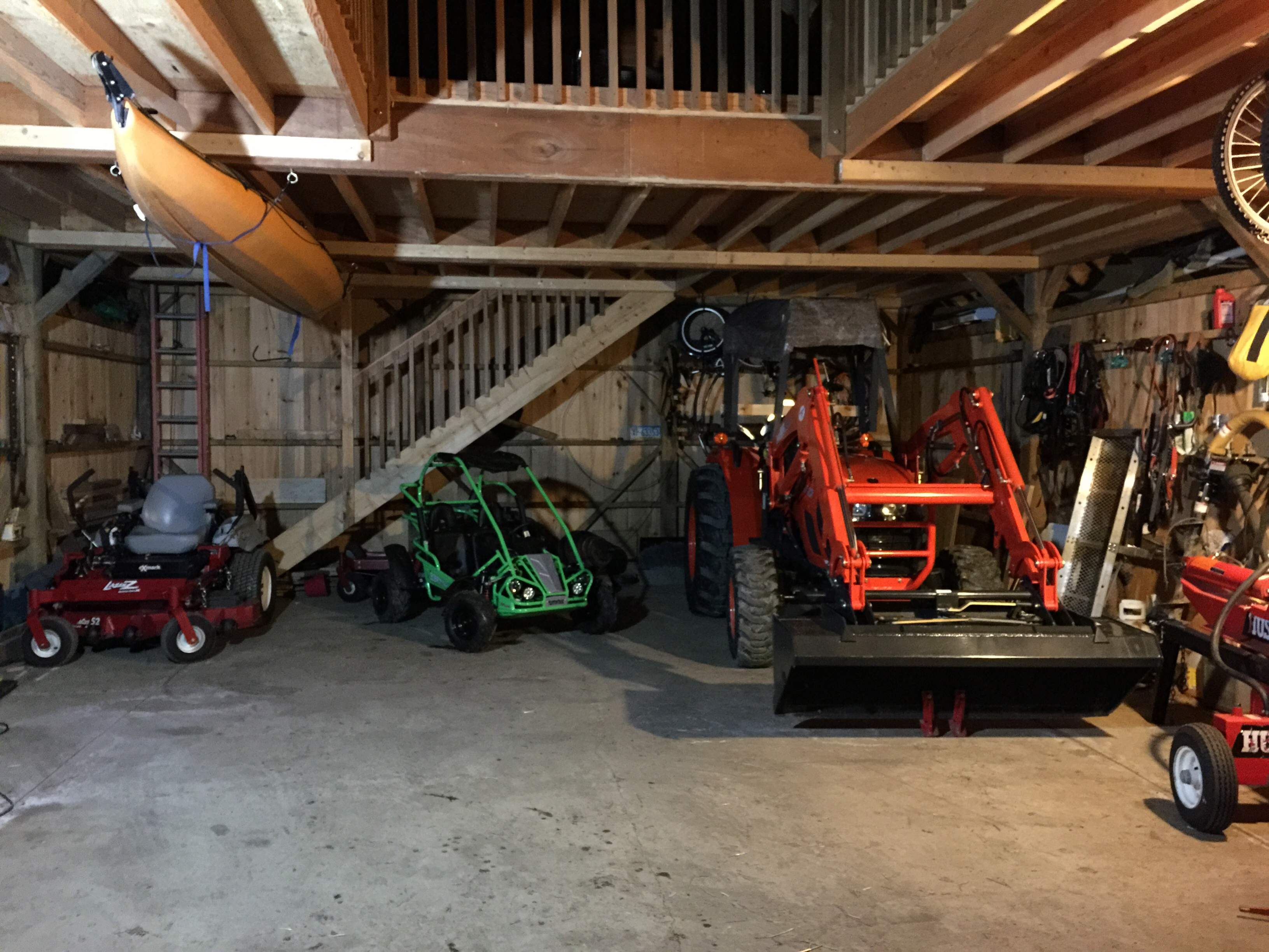

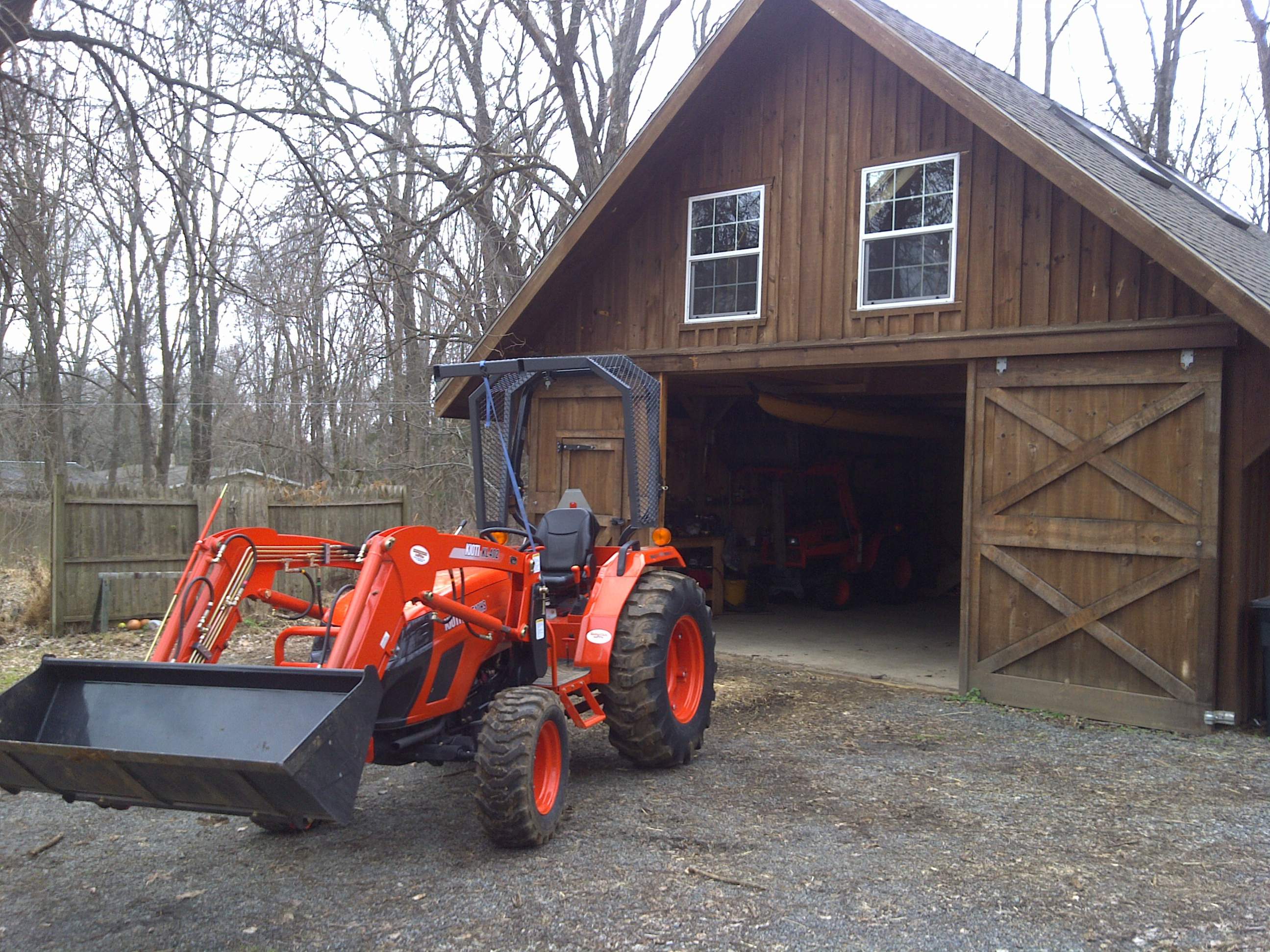

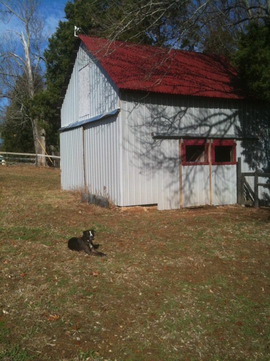

I built a 24x27 out building with a loft for ~$30K. I wouldn't do anything differently with that budget. However, with more budget I would go bigger. At this point I may eventually add a shed roof off the back and both sides for more space. As it is, I can keep my truck, too tractors, zero turn, log splitter, dune buggy and work bench on the first floor. The loft has a pool table and lots of storage under the lower parts of the roof.

That's a good looking barn Ron. I hope not to need anything bigger than that. Odd measure though. How did you end up at 27' and not 26 or 28?
It was a zoning issue and I didn't have the money to go for an exception. Original plan was 24x30. In my zoning we have a max square footage for out buildings a and I already had another building eating into that total squad footage.

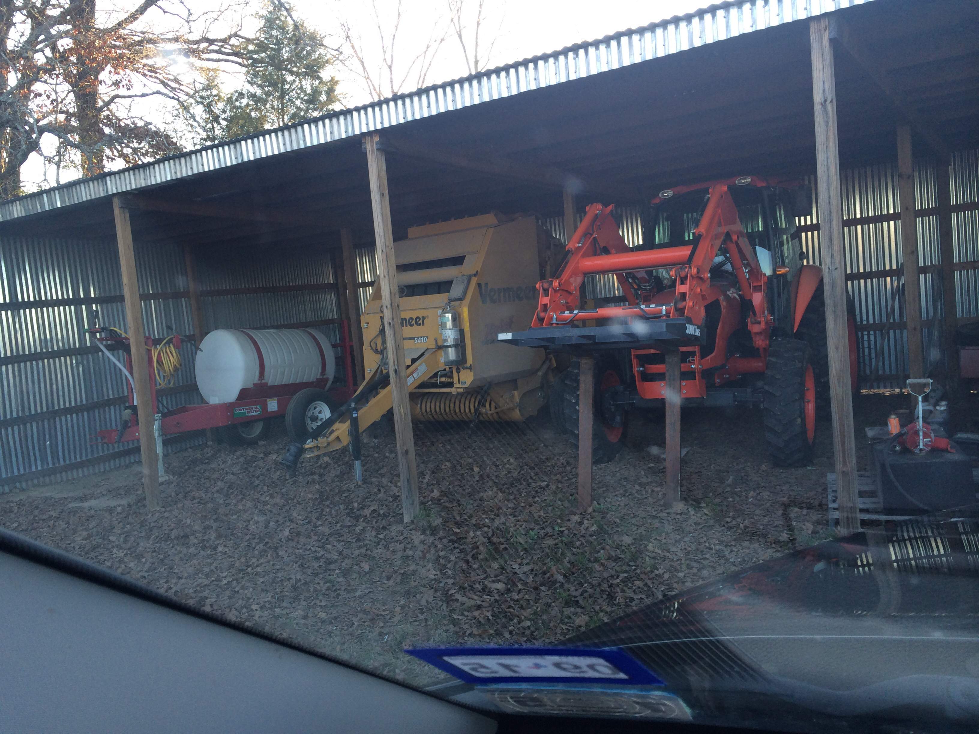

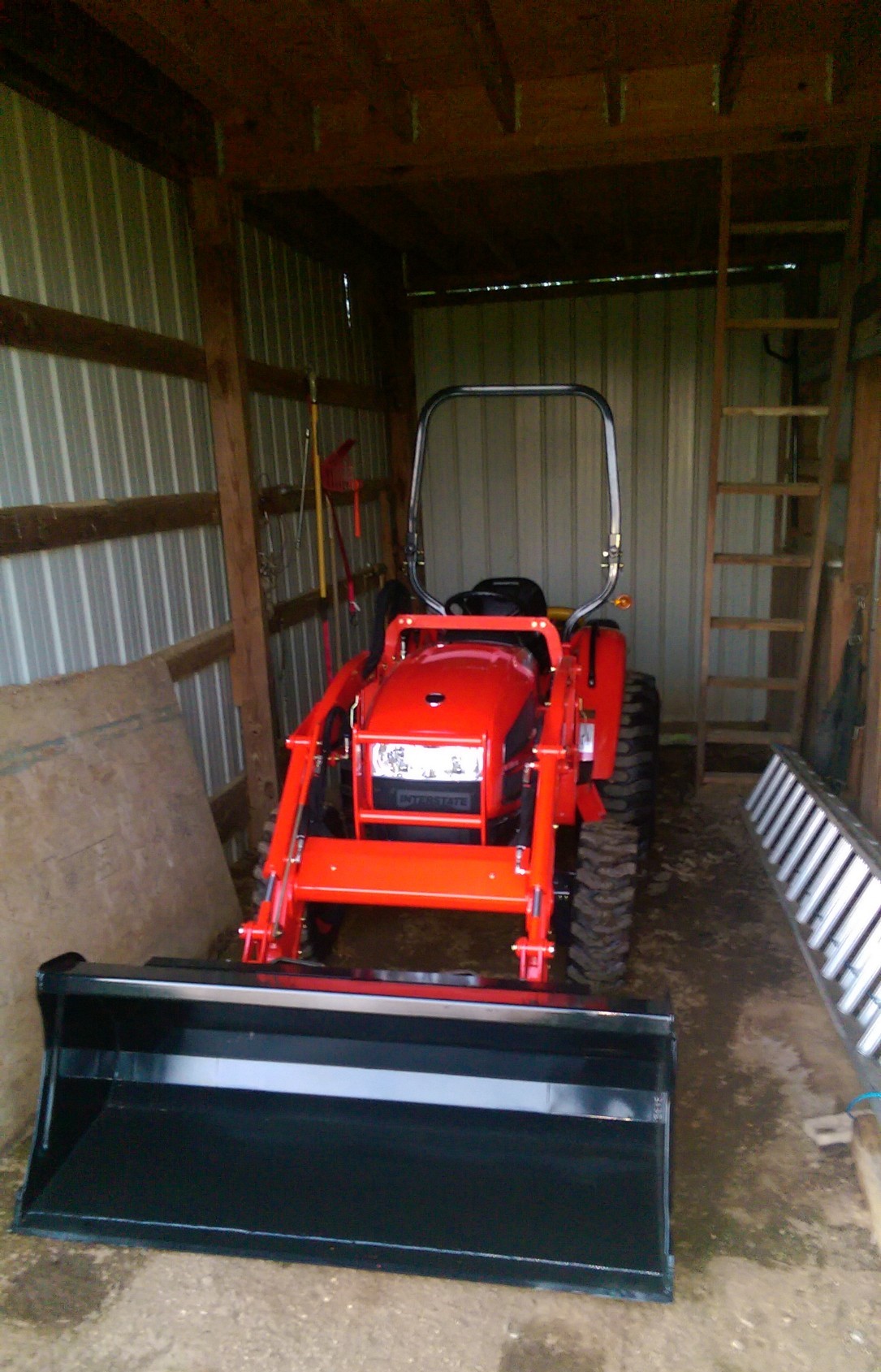

image.jpg I had a 20x40 built cost was $2400 total. Things I would do different make it a little deeper maybe 24' and a free span on at least one side instead the 4 post cause I can't get a few pieces of equipment between the post. I did build a smaller 20x20 with one side 12' wide but I wish had done it on this one and not the one by the house,cause my 15ft batwing takes up the one side now.
