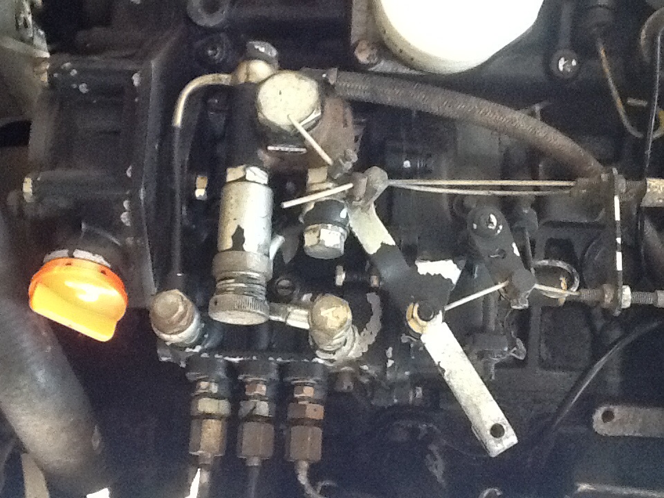

Hi guys, Can anyone help me? As you can guess from the title of this post, I know very little about tractors.
I've got a Lenar JL254 II (called power chief here in NZ) I've been looking for an operators manual, still have no idea where to get one. So I don't know what sort of fluids to use or where to put them.
The problem I have right now is the diesel pump oil (I think it's the diesel pump)..
Also I have no idea which type of oil to use, or how to get it into the pump. There is a small stick showing the oil is very clean but just below minimum level. Can anyone see the fill point from the attached picture?
As you can see there are two sticks on the left, the lower one goes into the sump, the higher one seems to go into the pump.
No idea what that orange cap is for, it looks like it goes to the engine oil, but there is a cap on top of the engine too.
So the question is, what sort of oil do you use in the pump and where does it go in?
Many Thanks Wotsthat
   / where does the oil go in? Lenar Jl254 II #2
On mine there is a breather that looks like a brass mushroom. It screws off with my fingers.
many thanks quicksandfarmer :thumbsup:
I can't see anything that unscrews on there, but now I know the oil type, I will get a small funnel and get some oil in there via the stick hole.
