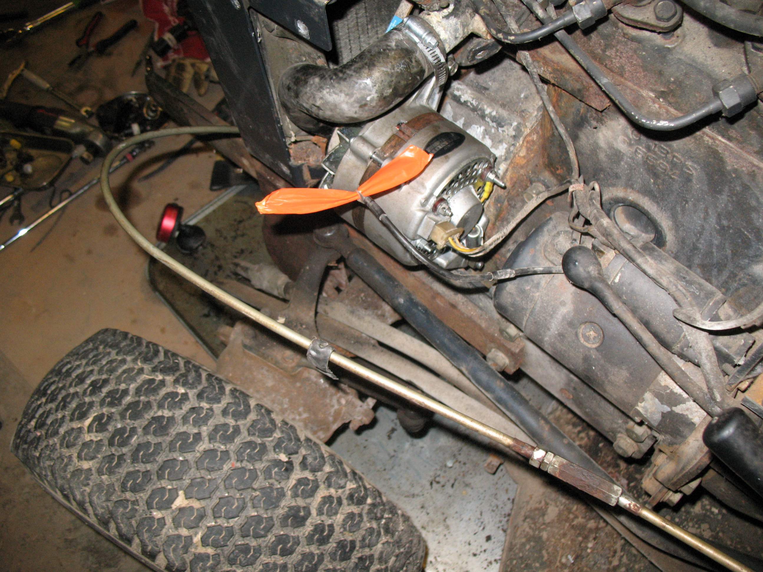

Hi Guys: I was having so much trouble with replacing the fan belt that I don't know where this wire goes. I don't remember taking this wire off (the one with the orange ribbon on it). It has 12.5v all of the time. The starter will not turn over the way it is, but the lights turn on with the ignition.
I would appreciate any help. Hope you are all having a nice holiday.
Brady
Edit: I just tried to crank it momentarily to line up the PTO shaft. Is there some sort of safeguard that the heaters have to be hot before it will crank?

I found out where it goes, to the terminal on the right which already has one wire connected to it. It should be labeled 'B', but I couldn't read it. The other two are labeled 'E' and 'N'.I found out where it goes, to the terminal on the right which already has one wire connected to it. It should be labeled 'B', but I couldn't read it. The other two are labeled 'E' and 'N'.
It didn't crank, because I did not have the clutch pedal depressed.
