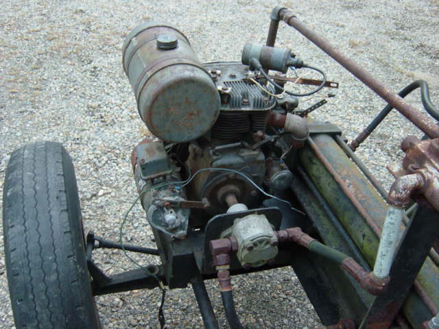

No spark. Model BKND engine. Where does this wire go from the coil?
Thanks!!!!

another view

The route is usually battery to large term on starter solenoid,then a lighter wire to a switch (key) then to coil,then out of coil to points and condenser. If I'm seeing corectly you have a wire from coil to points and condenser (Neg.side of coil) so your white wire needs battery power.

Thanks mark. I found the repair manual online - complete with electrical schematic. With my superior reconnaissance I will launch a surprise attack on the wiring. /forums/images/graemlins/tongue.gif /forums/images/graemlins/tongue.gif
