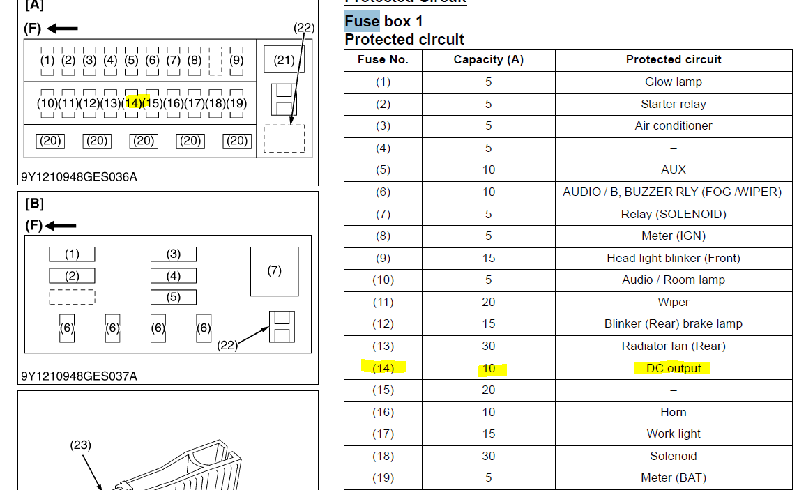

I see from my rtv 1100 manual , page 25 that accessory plug is not to exceed 120 watts, if that helps , it does note on page 94 that there are 2 fuse box but beside each other see pics , I suspect it fuse 14 in fuse box 1 , it is just called dc output , see pic 10 amp. But better labeling is needed by kubota.

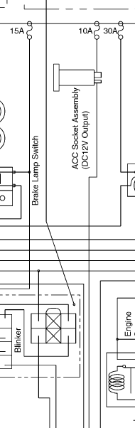

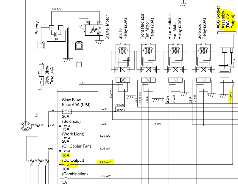

Probably not much help in this situation since it was most likely modified as suggested but here's a snip from the workshop manual electrical diagram:
Electrical circuit diagram:
And to wawajake's comment, it is labeled. "DC 12V output" in both so most likely fuse 14 as wawajake mentions.
   / Where is cig lighter fuse on Kubota RTV-X1100C?
OK - to put a wrap on this:
Thanks Plumcrazy814 and wawajake. The fuse for the cig lighter is indeed 'DC output' #14 in fuse block 1. Feel like a bit of a bozo for missing that, (thinking it was 'aux'), but I do that often when I'm troubleshooting something and there is more than one thing wrong. The old GPI pump motor had tanked, and it blew the inline fuse, but also blew the DC output fuse in the ATV power vehicle. Blew kinda funny, too - it didn't burn where they usually do, in the middle, but way over on one side. I'm still not acclimated to these new little fuses.
Answering George2615, the DC output fuse has a 10 in it from the factory; the tech upped it to a 20, and it worked fine for years with no problem until the pump motor exxed recently. It has been replaced.
